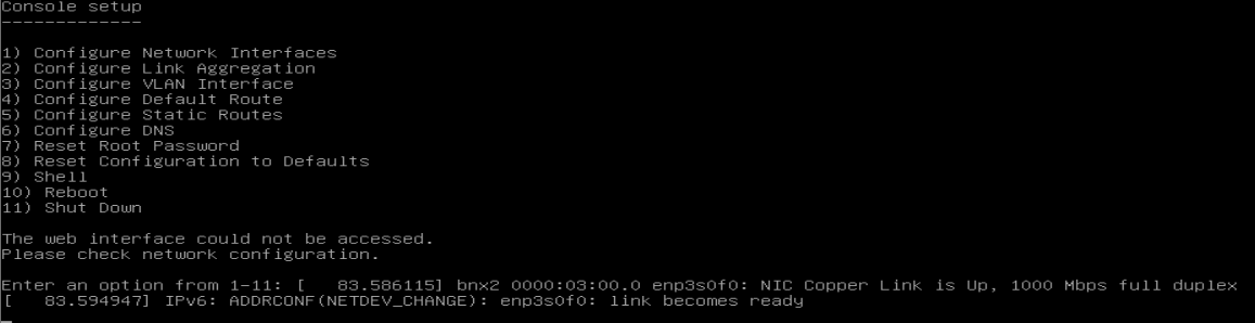

Network access broken every update/reboot
no_connection
Dec 15, 2013
480
Going into network interfaces and remove config from any interface or vlan(preferably unused) resets it to working order with IP/conf still in place.
I assume this is not a feature but a bug, and since it's a NAS a pretty serious one.

Using that command did not work(error out), and if I do up for the interface it completes but do not fix the problem. I did not dig further but I think the interfaces are already up and shuold work fine (have to verify later).
no_connection
Dec 15, 2013
480
Manually bringing them up after boot did not work but putting it in pre-init script/job works. Thanks!
It does look like some script don't want to wait until interfaces are up and running and breaks, but running ifconfig enp3s0f0 up it in a script before ensures it happen before that so it works. I would call this a bug in a NAS appliance/server, the user should not need to jump through hoops to get basic functionality working. I would suggest some integrity script running to ensure network functionality.
Fun fact if you enter configure network interfaces in shell and then quit with q it interrupts network for UI a short while even tho you didn't do anything.

@no_connection In the case shown in your first post, what happens if you enter the shell and use systemctl restart ix-netif.service ? Is your network config restored?
no_connection
Dec 15, 2013
480
@KrisBee I just tested and yes it looks like it works to bring it up.
Should I add back the startup script or keep it as is and see if it gets fixed with future updates? I have iLO so it's a thing I can do for testing.
