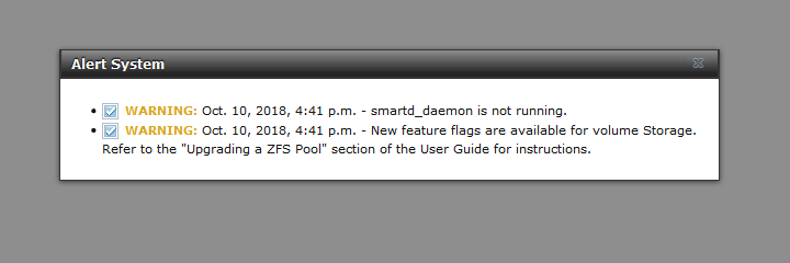

Whenever I'm logging into the web GUI, I'm getting this warning "smartd_demon is not running". It has been like this for past few weeks. My NAS is working fine however. Should I be worried or should I ignore it?
Thanks

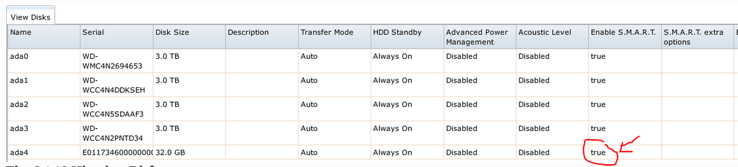

See the column of the disk view that has "Enable S.M.A.R/R" as the column heading?

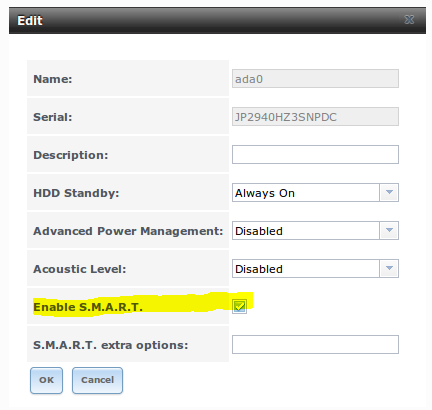

That circled element is what you need to change. So click the disk and select the option to edit the properties. That will open another menu that looks like this:
Just uncheck the box and click OK. The SMART daemon should automatically start.
