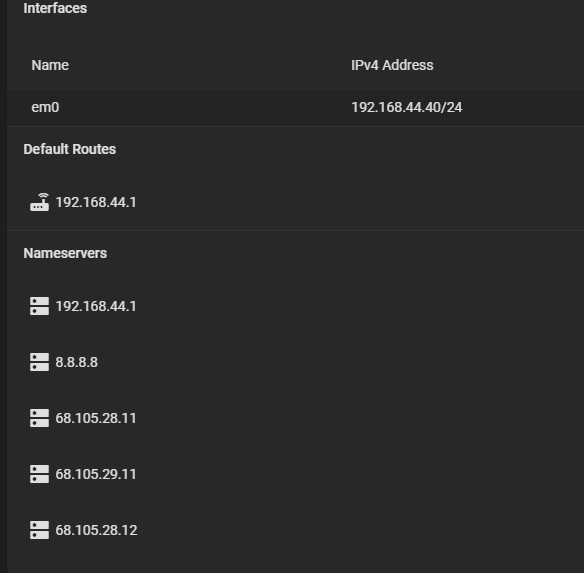

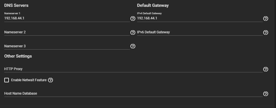

I'm fairly new to TrueNAS. Tried to look through forums for the answer, but everything I find is unrelated and old.
I have a fresh install of TrueNAS-12.0-U4. How do I remove the additional DNS entries the core is picking up from my ISP/Router?
I do not want any other entry but the one I specifically set. So I want to remove the ISP 68s. I have no other DNS services on my network. Other than the router it self, which is configured for the google address.

Make sure you're not using DHCP to configure the interface. That's the only automatic source for this information.
That is what I thought. I reverified the DHCP is disabled on the other interface. Didn't think of rebooting the core, but it worked after a reboot. Thank you. It's been a long night for me, was banging my head.
