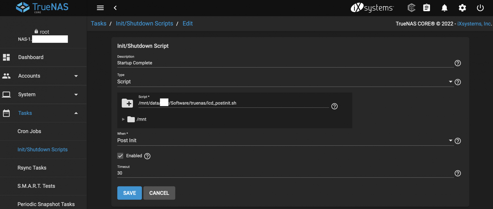

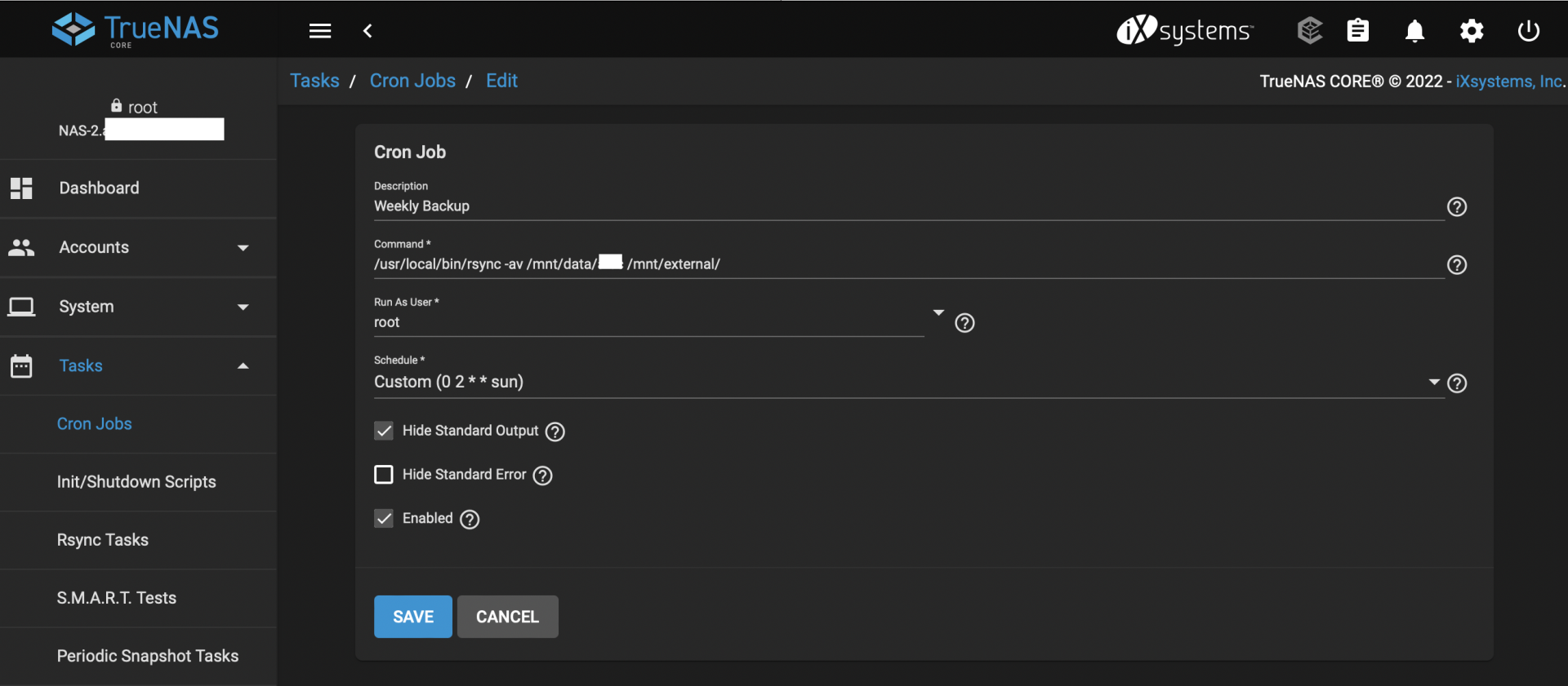

The easiest solution is to just keep the USB drive plugged in and create a cron to rsync the data to your USB pool. Assuming you have not set up a share (SMB, NFS, etc.) directly to the USB drive, clients will not be able to access the USB drive.
Anything fancier you would likely have to create a script (bash, python, etc.) to monitor for the existence of the USB drive to execute what ever commands you desire, then launch the script as a background process via a cron at boot (@ reboot) or simply launch it as a background process as a post init script. Just put the script on your data pool, add execute permissions (chmod a+x), and add the "&" after the script command to launch it as a background process. You might be blazing a new trail, unless someone has already cooked up something similar already.
