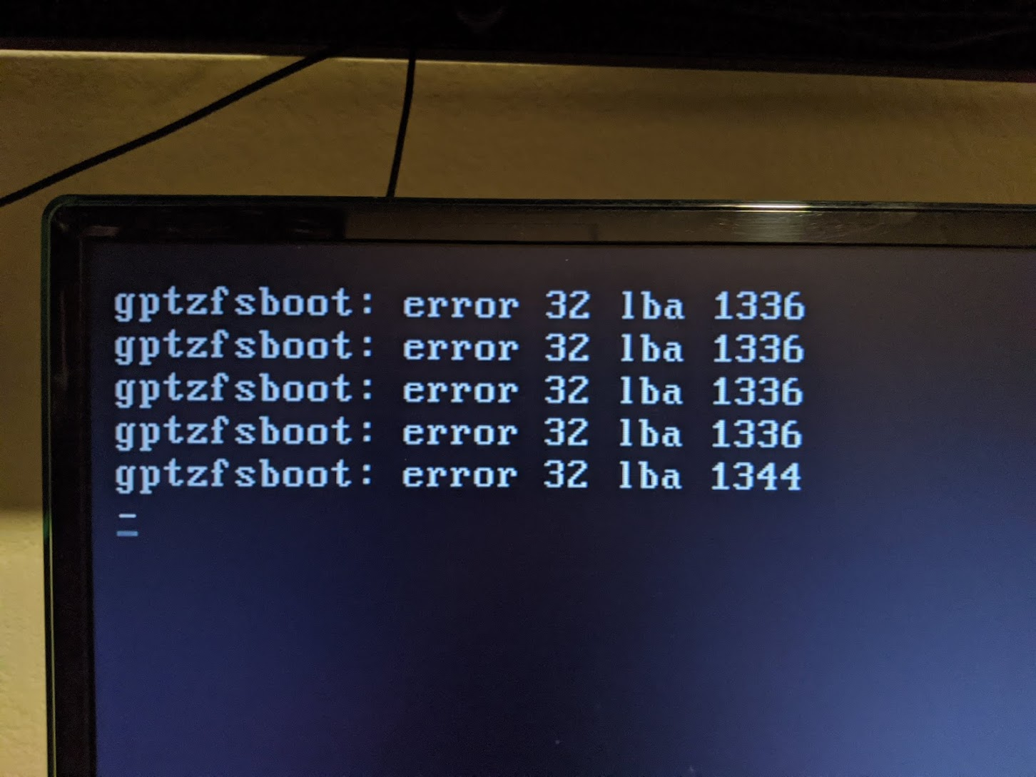

I managed to enble the boot from my Flasdrive as originally done. The jumper setup somehow changed and I had to get a different configuration to enable the usb header as a bootable device. This leads me to think if there is a change on the hardware configuration. I now have this error:
Well, as per my searches this indicates that the disk array is somehow wrong. Well, I got all my 8 disks labeled and also the cables connecting to the motherboard. Does anyone can put some light on how to address this?
