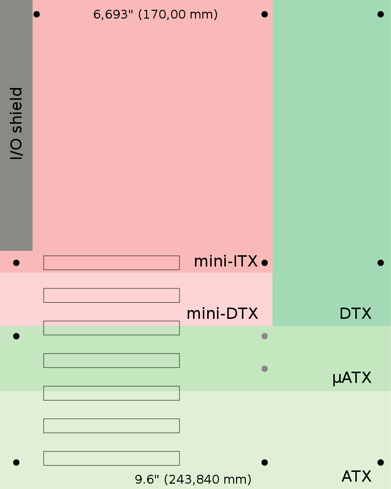

actually does care
Administrator
Feb 6, 2014
5,112
Mini-ITX uses only four mounting holes that are within the standard ATX spec, so I would be very surprised to hear of it being incompatible.
(Click to enlarge)
