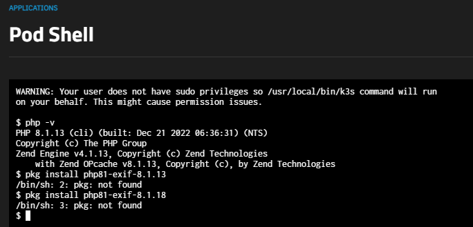

Thank you, John! I'm still having problems. I would very much appreciate a bit more direction on this.
When I run php -v from the Nextcloud application shell I get version 8.1.13. I tried installing the exif package using that version ending in 13 (php81-exif-8.1.13) as well as what you posted, php81-exif-8.1.18. Both said the package was not found.

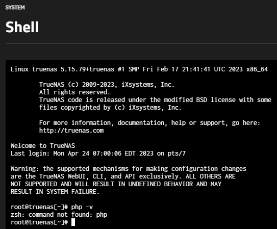

When I try to run php -v from the system shell I get the message: "zsh: command not found: php."

@wgb920 John Digital was trying to help you install Nextcloud in a JAIL on Core - not a container under Scale and has led you up the garden path I am afraid.
I don't use nextcloud - never got on with it but you install the container. The container includes nextcloud - you do NOT attempt to install nextcloud in the container or onto TN Scale - that won't work.
You should not be trying to install exif onto TN Scale. Scale is an appliance OS, not a linux distribution and is not meant to be modified and you won't get a lot of help here to modify Scale.
