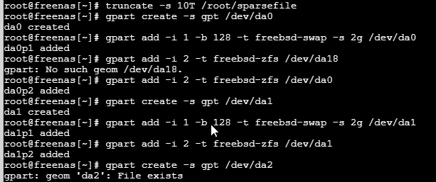

Hello,
Following the guide above, I am having an error saying that the
gpart:geom 'da2' File exists

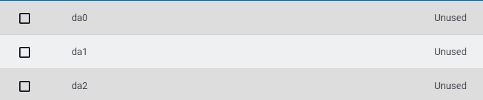

In Da2 used to be another drive that I installed temporary to backup some data.
Now this drive is outside my NAS and I do not want to lose its data.
If I destroy da2 will I loose the data on the drive outside the NAS when I put it back on later on another sata cable ...
Or does it has to be on the same cable as it is attached to this da2??
Can I destroy da2 without loosing data?
Thanks
9,700
Be very careful... the disk label assignments are not permanent for that disk and can change at any time without notice.
You need to pay attention to the GPTID (shown in glabel status) if you want to talk about a specific disk... also you could use the serial number shown in the disks list under storage in the GUI, which can be checked with smartctl -a /dev/da2 at the CLI.
If the disk currently assigned the label da2 is one you don't care about the contents of, destroy it without concern.
