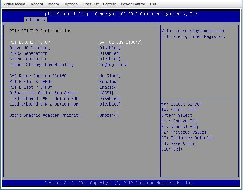

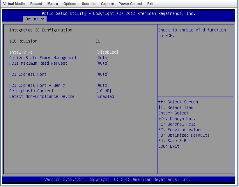

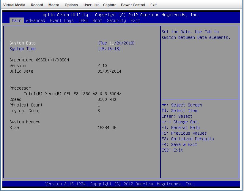

I happen to run this same board, here are my bios settings in regards to PCI.
I'm happy to show you what I can, to help out. Just say the word...
root@freenas:~ # dmesg|grep mps0
mps0: <Avago Technologies (LSI) SAS2008> port *deleted* irq 19 at device 0.0 on pci2
mps0: Firmware: 20.00.07.00, Driver: 21.02.00.00-fbsd
