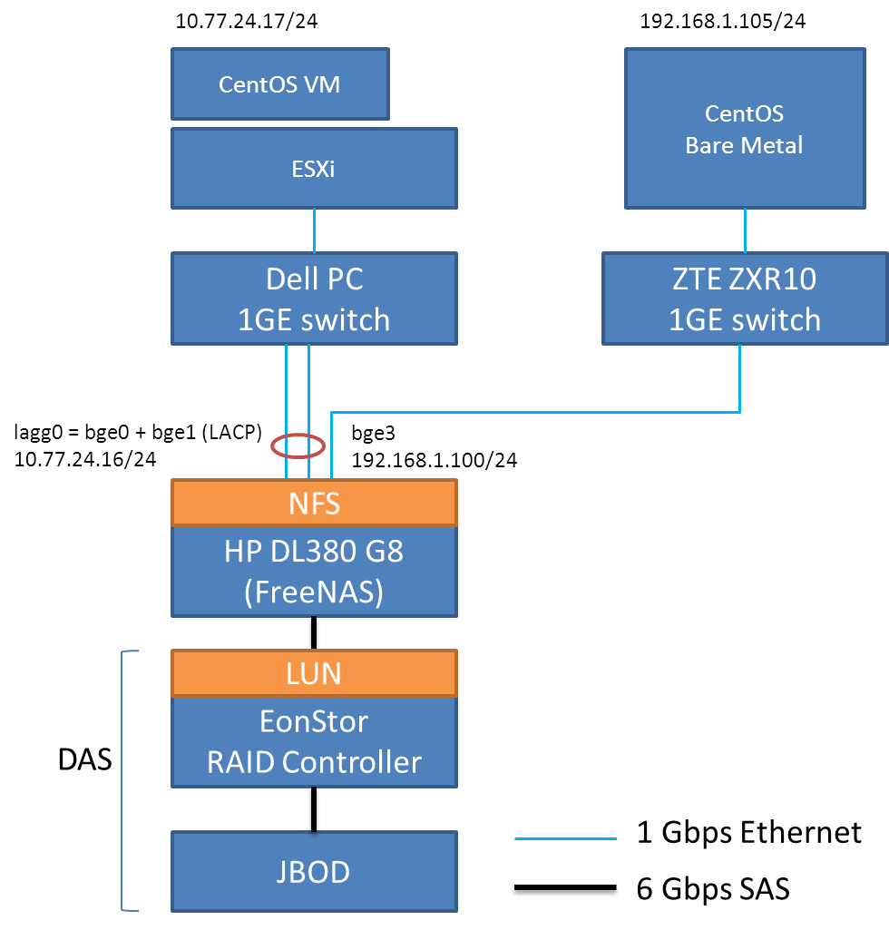

Sorry for my late post, I'm having quite a tight schedule on other tasks. Yes jgreco I keep in mind your comment since you first mentioned it (just that I have no access to office during weekend). More iperf test result is as follows:

(2) get rid of RAID Controller, now it become HP DL380 G8 (FreeNAS) sitting on top of JBOD (EonStor J2000R), write speed is still 20MB/s. However, doing this from bare metal CentOS client:
 dd if=/dev/zero bs=2048k count=10k | nc -v 192.168.1.100 2222
and correspondingly at server
 nc -v -l 2222 > /mnt/ZFS-Stripe/testfile
it gives 100+MB/s write speed. Context: ZFS-Stripe on 1 disk, no atime, no dedup, no compression.

So something is up with your network stack somewhere. I assume that NFS/CIFS reads are still fast from your FreeNAS server and writes to it are slow. What is difference between the slower protocols (NFS,iSCSI,CIFS) and the fast ones (nc, iperf)? hmm....
Looks like driver support for the BCM5719 network card is fairly new in FreeBSD (looks like there were some bugs in the bge driver first fixed in FreeBSD 9.2). Are there any interesting messages in your syslog -- specifically anything to do with the "bge" driver? Do you have an Intel network card you could temporarily install in your FreeNAS server to see if it makes a difference? Alternatively you could play around with disabling any offloading features on your bge interfaces using the "ifconfig" command to see if that makes a difference.
Your original diagram also shows that you have set up a lagg group of two interfaces. Perhaps the LAG load balancing algorithm is buggy on either the FreeNAS (bge driver) side or the switch side . Can you temporarily get rid of the lagg group to rule that out as the problem? (although I see that your "bare metal CentOS" server is not connected over a lagg so that should rule that out.)

Hi guys, I managed to locate the problem. What I did is upgrade FreeNAS to latest version and remove Link Aggregation. I suspect the latter contributes to my problem, even if Link Aggregation itself works fine with iperf test and nc test, it seems to introduce strange behavior to FreeNAS...
Now with zfs sync=disabled I get 110MB/s write throughput and with zfs sync=standard I get 28MB/s.
As a matter of fact, eraser and jgreco did point out the network issue and even specifically link aggregation that I just realize it too late...
Thanks all for your effort, it was nice exchanging with you.
