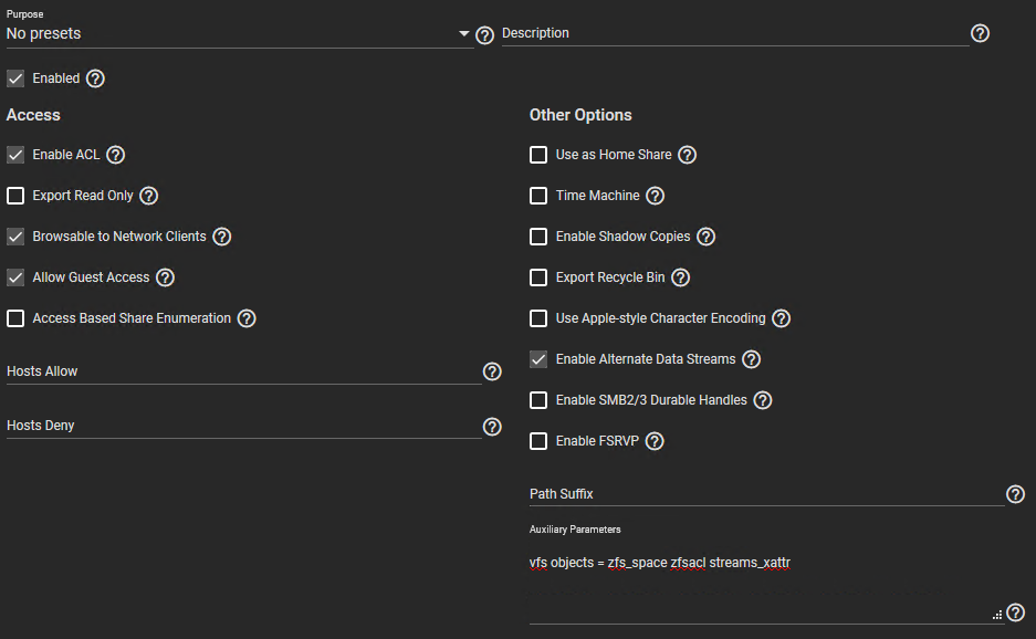

I'm referring to any auxiliary parameters in Services->SMB or Sharing->SMB where "full_audit" may be defined with logging parameters.
The only thing I have in the Sharing -> SMB section is "vfs objects = zfs_space zfsacl streams_xattr" otherwise the services one is empty. I normally don't put anything in there, so I am unsure where I picked up the current value.
