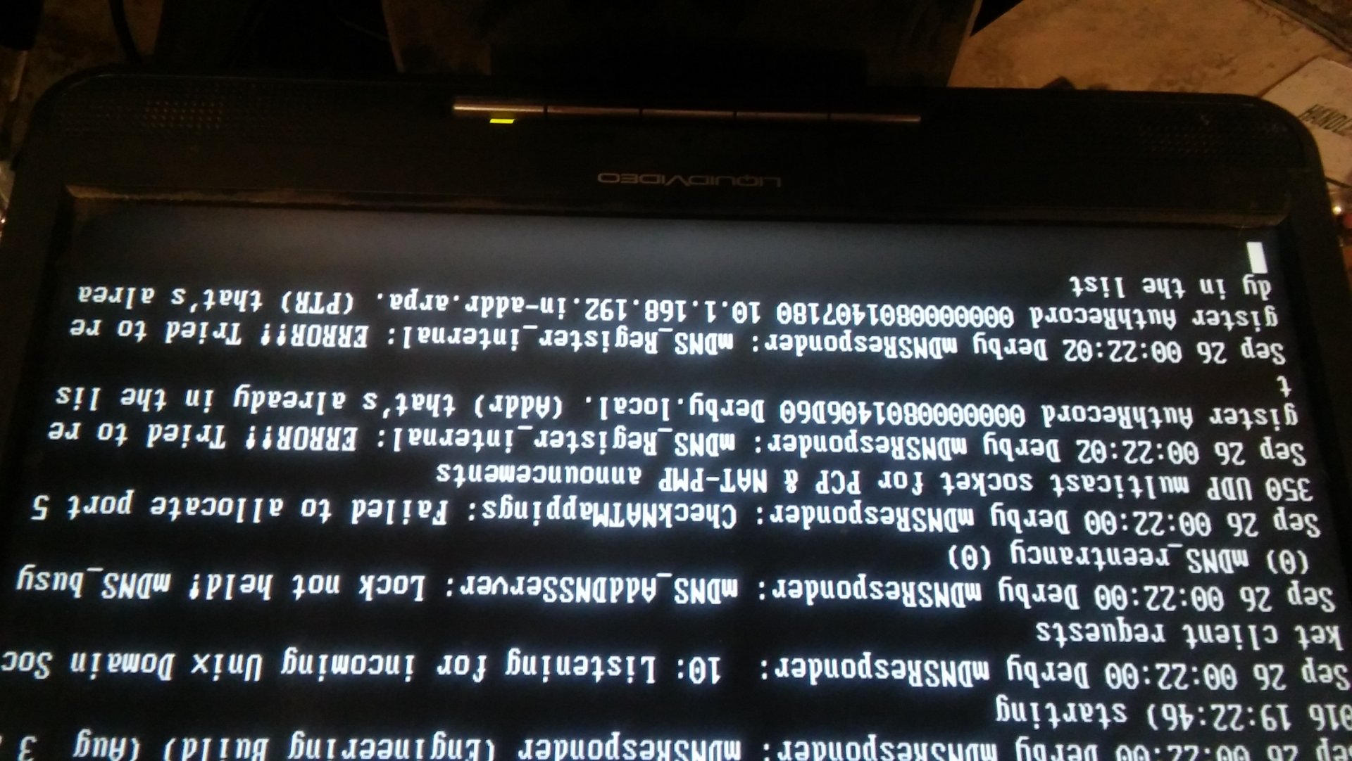

And the only errors I see are on the monitor on the freeNAS machine so I took a picture because theres a lot of text..
photo.php
Cant figure out how to put it in here. But windows says "Error 0x80070043 Network name cannot be found" when I click on root or homes folders..

In that text on the FreeNAS monitor I see the IP address is there, but backwards (10.1.168.192). How can I upload a picture of that? Or is there a way to just send it to you?

What address are you using to access the GUI? Maybe that 10.1.168.192 address is correct? Very strange that it is backwards ish
It's funny since it's backward, but it's a perfectly valid private network address.
It's either a cruel joke to make developers chase endianness issues or a very weird coincidence.

To access using google chrome, 192.168.1.10, since day one it's never changed. Will try to upload that picture tonight

No clue why that posted the picture upside down.. Sorry.. Will repost if you'd like

You're address isn't backwards you are just looking at a log message that is telling you something not related to what you use to access the GUI.

In-addr arpa addresses are backwards. They're for reverse lookup. So they're in reverse ;)
