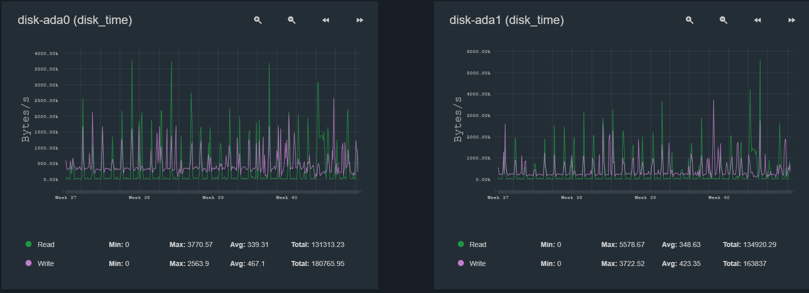

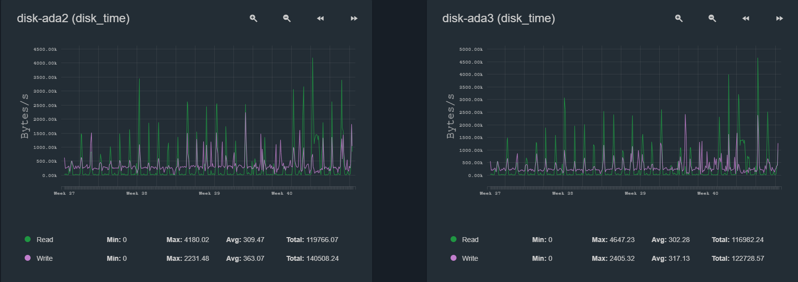

so now, I am not so sure that it is one disk that is the problem. However, also strangely, this part is always the same from the /data/crash/info.x logs:
Dump header from device: /dev/ada3p1does this indicate that /dev/ada3 could be a problematic disk?
