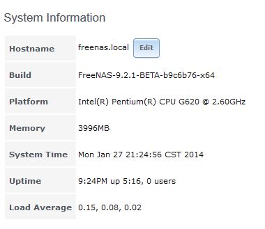

No plugins or anything special. Very lightly used 1TB system on a home network.

I noticed its 9.2.1 Beta.. Have you enabled autotune or done any kind of tuning at all?? It's akso 4gb - are you running ZFS?

Yes, autotune is enabled. It seems like it kept all of my settings in tact. Yes, I'm using ZFS. It hasn't been a problem up until the upgrade

How much memory in this system? Does removing the autotune settings fix the problem? Are you able to add more RAM?

I did not remove the autotune setting. However, it's done it twice today after working fine for several days. I can't afford more RAM right now. I haven't had much work lately. I did go back to 9.2.0 to see if that makes a difference. Not sure how I wound up with the beta. I should have noticed that in the file name.

You need more ram.. Alot more for ZFS via FreeNAS..

Normal? Using autotuning or any tunables with such little ram goes against the documentation and what the standard seems to be.. It would not surprise me if your speeds are actually slower then what you had before.. I'm pretty sure autotune etc is designed for systems with 32+gb of ram..

Oh.... he can't afford more RAM. I wonder if he'll be able to pay to get his data back when his pool goes to crap! Especially when he sees the cost of data recovery is significantly higher than a RAM stick.

Not to beat a dead horse here, but the 8GB minimum in the docs isn't really a suggestion. We've seen a bunch of people come through the forum with trashed pools on 4GB or 6GB. We don't know why; none of those with the problem have been able to debug. It works fine for people right up to the point where suddenly it doesn't.
As long as you have the budget for potentially unrecoverable pool failure, well, good. In my experience, fate does not target you right up to the point that you have irreplaceable data on there.
