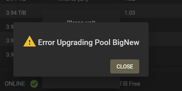

Hello,
It is sad to say, however after upgrading from 13 RC1, the first thing I tried is to upgrade my ZFS-pools.
With as sad result "Error Upgrading Pool"
I tried two pools, in both cases having this result.

It would probably be helpful to run zpool upgrade <poolname> from the CLI and post the output--both here and to that ticket.
Jun 2, 2019
590
I did the upgrade from the CLI
root@NAS-2[~]# zpool upgrade data
This system supports ZFS pool feature flags.
Enabled the following features on 'data':
draid
sepin4

Thank you for the help on this thread. Obviously I'm here with the same issue and upgrading the pool via CLI was the solution. Do I need to reboot TrueNAS after upgrading and adding the additional flag support?

Put me down for this issue too, makes me a bit hesitant, just a small bug?
Error upgrading pool.

Same issue here in GUI, and CLI cmd worked. Outputted updated feature enabled draid. woohoo!
