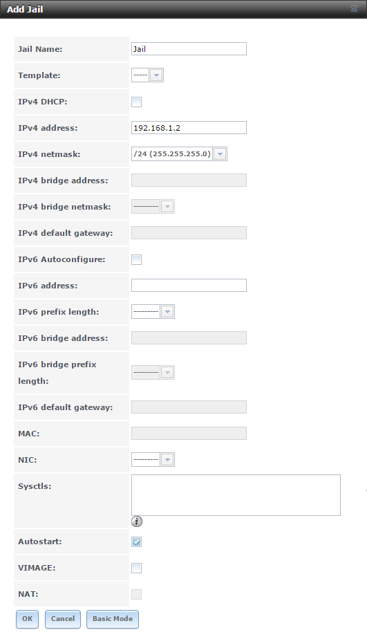

I was adding a jail in FreeNAS web UI. With Add Jail button I added a jail. For the first time it took a little time to finish. Then I opened shell from FreeNAS web UI. First I changed root password with # passwd then I wanted to update the jail

When I was making a jail I tried with VIMAGE option and without. In Template option there is just VirtualBox option or no option.
I already have some Plugin jails created and they all work.
What did I do wrong?

Were you able to resolve this error? If not, does adding a default gateway to that screen fix it? Is a DHCP server available in your network? If so, does switching to DHCP fix it?
