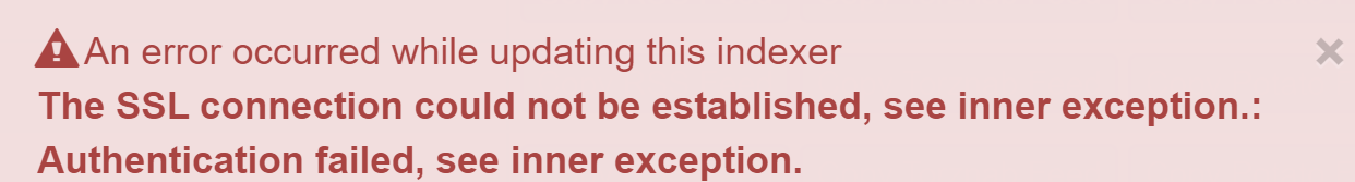

I have Jackett installed as a jail (mono version 6.8.0.96). For the most part I have not encountered issues except for adding losslessclub as an indexer.
Whenever I add it, I get an error that "The SSL connection cound not be establised..."
I have tried to add this indexer on a Jackett installed on a Windows machine and it runs completely fine. Afaik, this is only an issue on my FreeNAS jail.
I checked and the OpenSSL version on the jail is 1.0.2s. Do I need to update OpenSSL to resolve this? If so, how do I do that?
Here is the error log when attempting to add losslessclub.com indexer:
