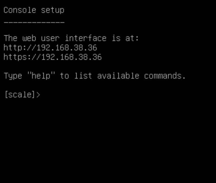

  2. Per this link, any versions of SCALE should be showing an almost identical Console Setup Menu to that of CORE with the same/similar options. My Console Setup shows no options at all but does display the DHCP assigned IP addresses that I can use to access the Web Interface. Has the traditional Console Setup Menu been supplanted by the new CLI? If yes then I can't find the equivalents to the original 1-11 options that the Console Setup provided.
Sounds like that's an already installed key, not the install ISO image.

I've just completed a fresh install with a reformat of the target media. This was completed with no add-on cards or additional peripherals but resulted in the same issues. It appears I am permanently stuck in the new CLI with no Console Setup options. I'm going to test with SCALE 21.06-BETA.1 to see if the result is the same.

I can confirm I don't see the console setup issues with SCALE 21.06-BETA.1. I think the phantom NIC is just the IPMI specific NIC and SCALE isn't provisioned to know what to do with it yet. I'll test an upgrade from 21.06-BETA.1 to 21.08-BETA.1 and see if things break or remain working.

@sretalla After the upgrade from 21.06-BETA.1 to 21.08-BETA.1, the Setup Console options are gone and I'm once again stuck in the new CLI. This is either intended behavior in this new beta or a bug....I'm inclined to think this is a bug as this is rather strange to be expected behavior. I cannot exit the new CLI at all and therefore cannot set up any key settings from the Console.

My console on Scale looks like
Is that what you mean?

Then that would be correct (or mine is also wrong)
:smile:
You can configure everything else from the GUI
Loads of commands available from that prompt too - just not obvious
:smile:
Interesting….Perhaps this is how it will be going forward and documentation is just not up to date. I’ve searched for ways to do many of the first time setup configuration changes but these don’t seem to exist in the available CLI menus. I guess GUI it is for now.
9,700
You could always drop out to a shell by typing shell [enter] then ifconfig to make sense of your network from there.
