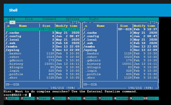

Your configuration files are automatically backed up to the system dataset once a day. As long as you didn't have your system dataset on your boot drive (it is moved to the pool by default), there's a good chance you can get a recent version back.

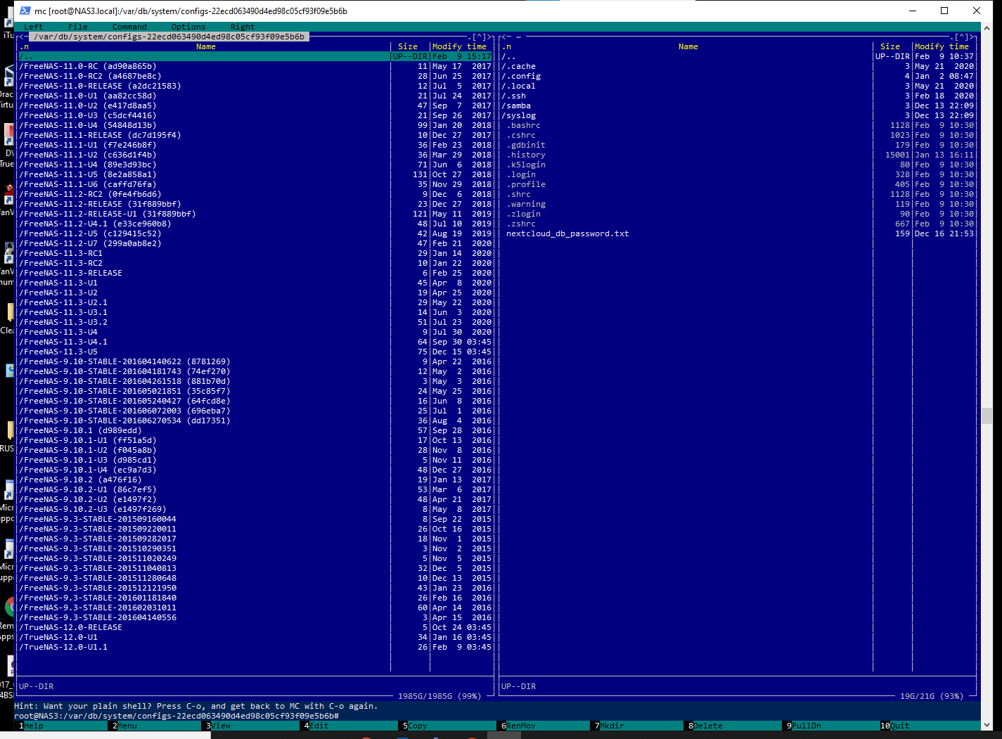

Look at post 35 in this thread https://www.truenas.com/community/threads/update-went-wrong.74084/page-2#post-514298. It gives the location where the files are placed by default and describes how to get to them.
You'll see a section where Chris describes a "kind of tricky" procedure to get to the files - I recommend that you use Midnight Commander - a DOS-like file manager built into FreeNAS/TrueNAS - type "mc" on the command line to get to it:
I pulled it up there in the shell to show you, but it's better to SSH in to your box and use it that way if you have SSH set up:
You can see my config file from today at the bottom of the list.
I'm pretty sure that it's this process that Dan T. was referring to.

Finally got to get in and try this today. When I go into there as you and Dan had suggested, I only see the newest config file within the /configs - xxxxxx. There is nothing prior to the crash.
Is there any other way to get at the config?
