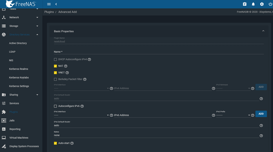

Thanks Yorick, the second suggestion works for me. You are correct that the default NAT does not work at all. For DHCP, I still got DNS error but anyway, problem solved.
Here is the workable setting screen capture:
