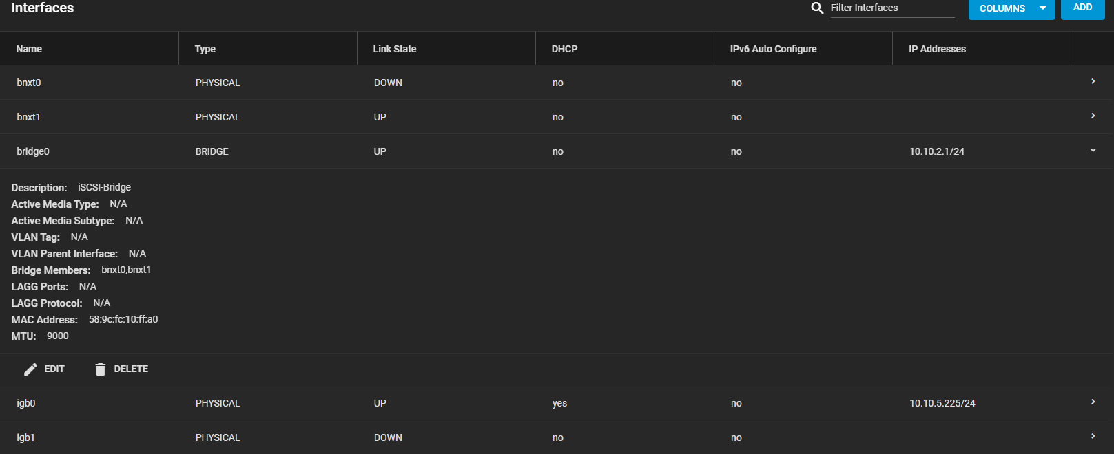

Hi, i´ve a truenas server with 2x 10GB NICs. I first configured nic1 with static IP: 10.10.2.1/24 and added an iSCSI-Share to the configuration. i got a working connection from a test ESX-machine to the truenas-server share to the 10.10.2.1 target.
Now i´ve configured a bridge with members nic1, nic2 and set the ip-address to 10.10.2.1/24 (the old nic 1 has no ip address configured). but it only works on the original interface nic1. if i plug the ethernet cable to nic2, i get no connection. i alredy rebooted truenas and esx, but it won´t work. any ideas? is there a configuration to link the iscsi share directly to an interface? or what am i missing? thank you
portal configured to: 10.10.2.1 and 0.0.0.0 - no change
