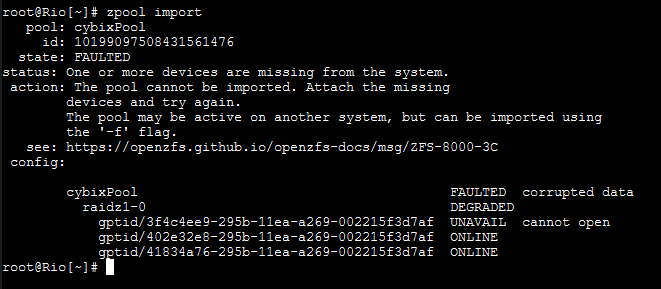

I might have missed some warnings, anyway, here we are.
I have a 3-disk 3Tb RAIDZ1 with one disk dead. I have a removed the disk and replaced it with a new but the pool isnt online anymore. Is this recoverable?
I have read that if the pool is being flagged as FAULTED, there is nothing to do, is that correct?
/Peter
9,700
You may get some results with the -f or the -F flags with the import (note that -F may lose the last few transactions to discard bad data).

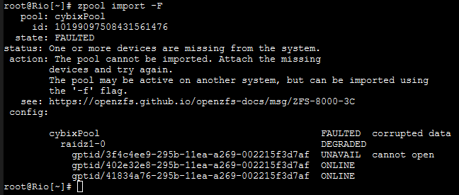

Thank for the answer!
Ran both commands without any success:
Says the same thing.
/Peter
9,700
I note that you're not trying to import that pool...
zpool import -f cybixPool
That may or may not succeed.
Depending on how much you stand to lose if the data is gone, you may want to try an option like Klennet (which is a quite involved process to set up (on a Windows machine) and is "expensive" when the time comes to license it to recover data).
