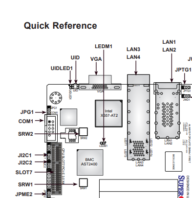

Is the BMC Heartbeat light blinking?
Redcoat
Feb 18, 2014
2,922
No - the hearbeat light on the mainboard LEDM1:
Redcoat
Feb 18, 2014
2,922
The heartbeat light on the motherboard is not lit or blinking.
The system is working fine except for the IPMI. Can I buy a replacement IPMI module without replacing the entire motherboard?
OK.
Last thought from me before deciding that IPMI HW is dead - have you replaced the ethernet cable between the IPMI port (Mobo Port 1) and your router or switch with a known good cable and looked for solid LED and flashing LED at ports at both ends?
With respect to buying a "replacement IPMI module", I doubt it as AFAIK this is all integral to the board. Given the issues reported in your 12/25/21 posting, might there be a chance of warranty coverage?
