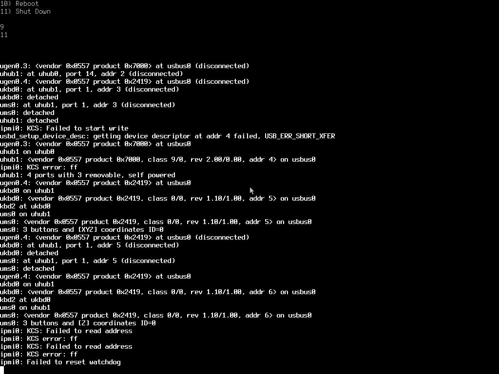

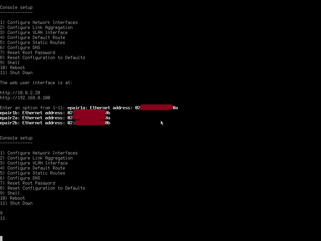

I'm having some trouble with one of my boxes. I think the router is having malfunctioning of some sort and is intermittently dropping connection.
The fact is that as a result (?) FreeNAS UI is not accessible and, above all, FreeNAS console (over IPMI) is unresponsive:
At the moment I cannot physically access the machine and the only thing that helped is resetting the box via BMC.
The box stays online for a while after each reset and then goes silent with the above behavior.
By insisting on the console this happens:
Looking at the logs is see a lot of:
But even if the link is intermittent the console should still be usable.
I downloaded the Debug info archive. Any advice on where to look? I'd like to understand why it freezes like that.
igb0: link state changed to DOWN igb0: link state changed to UP igb0: link state changed to DOWN igb0: link state changed to UP igb0: link state changed to DOWN igb0: link state changed to UP igb0: link state changed to DOWN igb0: link state changed to UP igb0: link state changed to DOWN igb0: link state changed to UP
