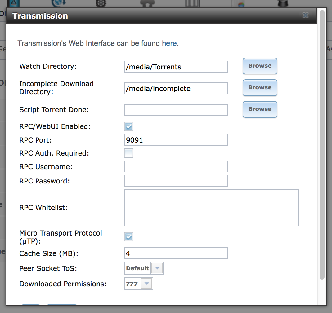

Hi Georg. Yes I have an incomplete directory set up....
Georg Kullgren
Feb 6, 2016
25
Then I'm out of ideas. I found this description to be helpful though:
https://forums.freenas.org/index.ph...ssion-and-couchpotato-as-a-dlna-server.17165/
The permissions needs to be updated if you want any kind of security, but apart from that it provides a good description of the setup. The only thing missing there is the incomplete directory but you already had that covered. I did a few more things differently. I don't use dlna and I don't have torrents directory. Instead I configured Couchpotato and Sickrage to connect directly to transmission.
