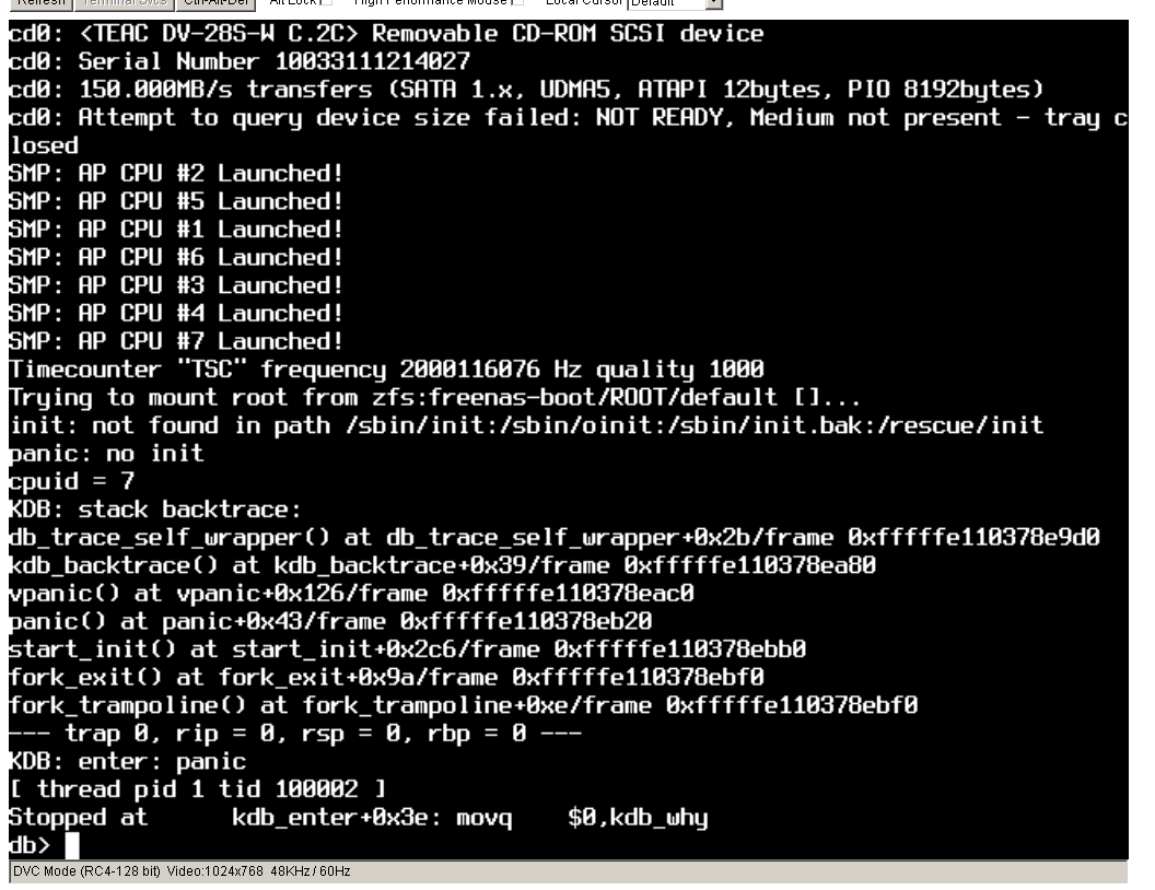

Hey Guys,
i had try to install the actuall release on a dl360 g6 with sata SSD and after reboot a crash occure. I post a pic from the crash. Any Ideas for me?

What version of freenas? Looks like a bad install or unsupported hardware.

thanks for answering. I use Freenas 9.10 and also try Corral, but both has the same issue. The DL360_G6 is a standart Proliant Server and Freebsd works very well on it.

sorry for the delay, now i write the Error Message. I try it with 9.10 and Corral hast the same issues.
Timecounter "TSC" frequency 2000116076 Hz quality 1000
Trying to mount root from zfs:freenas-boot/ROOT/default []...
init: not found in path /sbin/init:/sbin/oinit:/sbin/init.bak:/rescue/init
panic: no init
cpuid = 7
KDB: stack backtrace:
db_trace_self_wrapper() at db_trace_self_wrapper+0x2b/frame 0xfffffe110378e9d0
kbd_backtrace() at kbd_backtrace+0x39/frame 0xfffffe110378ea80
then comes a lot of more panicmessages. Has anyone ideas? The Server is an DL360 G6 with 2x E5504 CPU and 72GB Ram 2 SATA 16GB SSD on a P410 configured es 2 indipendent single Raid0 Disks. FreeBSD 9,10 and 11 run fine in the same configuration.

Looks like bad install or install media. And you should not be using raid 0 disks, you will lose all your data with that config.
