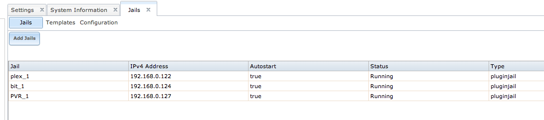

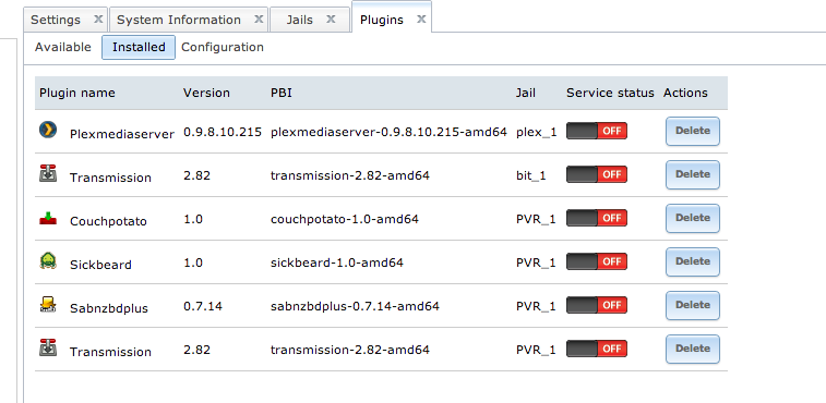

I was able to export from the 9.1.1 DB and import into the 9.2 db with only that single column update.
As you can see in the screenshots attached, the jails show up and run correctly. The plugins now show up under installed.

However then I hit "on/off" I get a green box at the top that says "some error occurred". Looking in /var/log/messages I see these messages.
Jan 17 08:01:03 freenas manage.py: [freeadmin.navtree:522] Couldn't retrieve http://192.168.0.120/plugins/plexmediaserver/1/_s/treemenu: HTTP Error 500: INTERNAL SERVER ERROR
Jan 17 08:01:03 freenas manage.py: [freeadmin.navtree:522] Couldn't retrieve http://192.168.0.120/plugins/sabnzbdplus/8/_s/treemenu: HTTP Error 500: INTERNAL SERVER ERROR
Jan 17 08:01:03 freenas manage.py: [freeadmin.navtree:522] Couldn't retrieve http://192.168.0.120/plugins/Sickbeard/7/_s/treemenu: HTTP Error 500: INTERNAL SERVER ERROR
Jan 17 08:01:03 freenas manage.py: [freeadmin.navtree:522] Couldn't retrieve http://192.168.0.120/plugins/transmission/3/_s/treemenu: HTTP Error 500: INTERNAL SERVER ERROR
Jan 17 08:01:03 freenas manage.py: [freeadmin.navtree:522] Couldn't retrieve http://192.168.0.120/plugins/transmission/9/_s/treemenu: HTTP Error 500: INTERNAL SERVER ERROR
Jan 17 08:01:03 freenas manage.py: [freeadmin.navtree:522] Couldn't retrieve http://192.168.0.120/plugins/Couchpotato/6/_s/treemenu: HTTP Error 500: INTERNAL SERVER ERROR
It appears to me that perhaps nginx isn't setup to know the plugins are available? But I couldn't easily figure out where that info might be housed. Suggestions?
