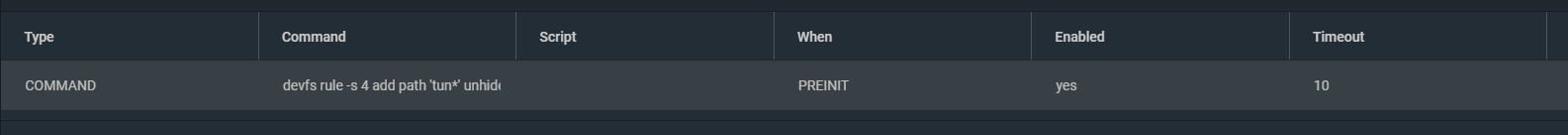

iocage create -n "transmission" -p /tmp/pkg.json -r 11.2-RELEASE ip4_addr="vnet0|192.168.1.23/24" defaultrouter="192.168.1.1" vnet="on" allow_raw_sockets="1" boot="on" allow_tun="1"
But in the new guide there's that line
devfs rule -s 4 add path 'tun*' unhide
that should make tun devices available in my iocage jail right‽ Yes of course, but what if it's already applied?
root@BlargNAS:~ # devfs rule -s 4 show 100 include 1 200 include 2 300 include 3 400 path zfs unhide 500 path tun* unhide root@BlargNAS:~ #
