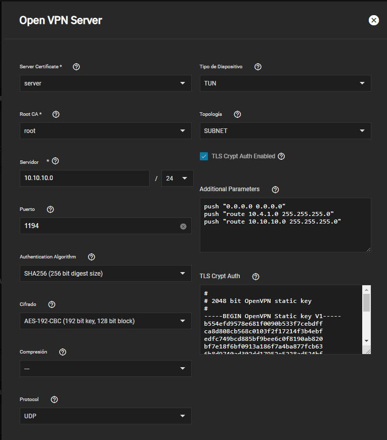

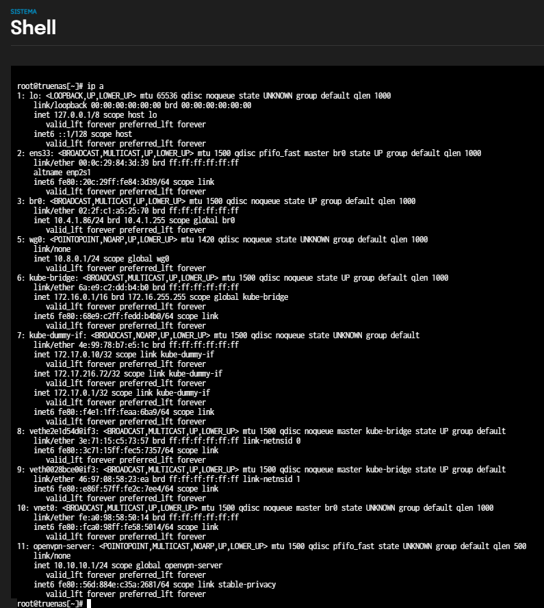

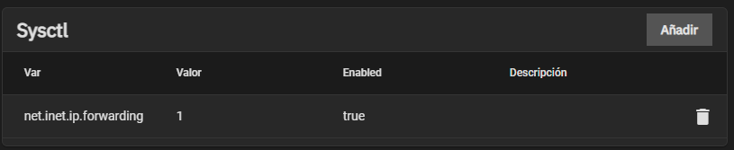

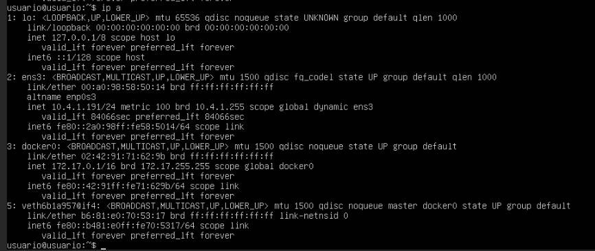

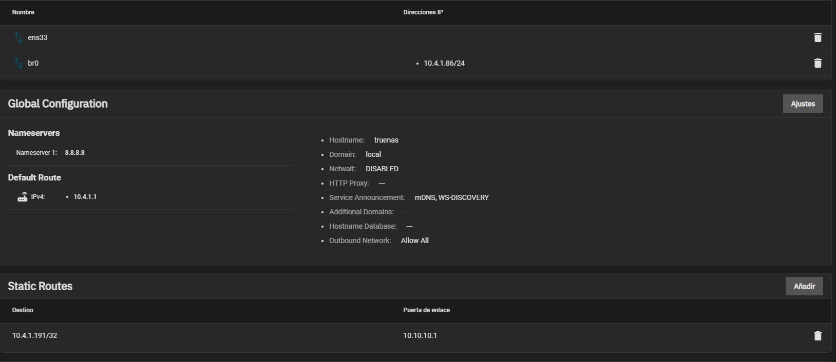

I need it works by open vpn but heres the problem.
I have open vpn servers working with certificates in 10.10.10.0/24, it connects fine, while im conected i see the nas and i can open de gui, but its impossible connect by ssh to the ubuntu server virtual machine or to the portainer.
I have been lookging and reading for a few days with out luck.
Here is my conf. can you help me please? wheres my problem??? Thanks!!!
openvpn server
advance settings
network
truenas
ubuntu server mv in truenas
