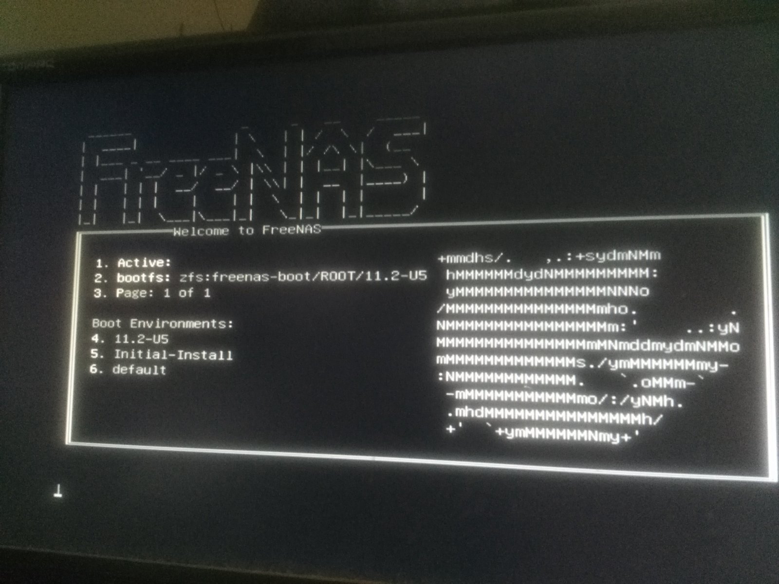

Updated to 11.2 u5 from 11.1 u7 and was running fine power down machine to move into different location fired server back up and freezes on boot

Turn the server on and when the FreeNAS boot appears, press the space bar to pause the boot. You will see four options. Option 4 says: Select Boot Environment - press 4 to activate it.
On the next screen you will have a list of previous envioronments, select the previous one before upgrade and you should be back. Below the ones from my server:

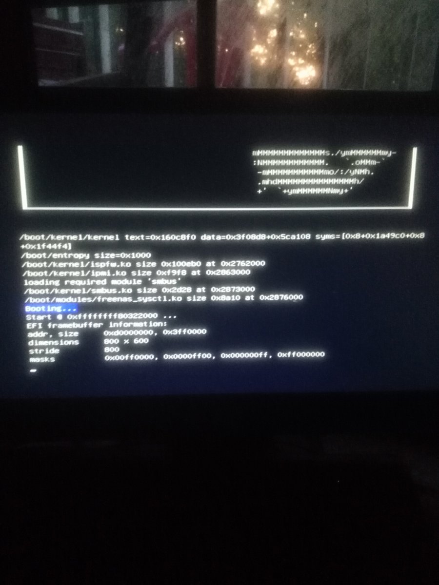

Well it's working but not i upgraded from 11.1 u7 to 11.2 u5 and that option is not listed it looks like for what ever reason my setup dose not like 11.2 for what ever reason

Now it's in a boot loop just keeps starting over
I do believe you will need to reinstall, import your pool, and start over. I'd do it with the previous version you were running, to ensure ZFS compatibility. You can find all of them here.
Also keep in mind your configuration is bare minimum and probably not following the recommended hardware. So that might be the root cause of your troubles.
