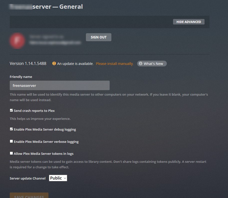

The ports tree is great but sometimes can take awhile to update to the latest version. I use the web version of plex alot and the update nagging forced me to figure this out. I discovered there is no other good tutorial to accomplish this. So here you have it.
First you want to be ssh'd into your FreeNAS Host. Use putty or your favorite terminal to do this. Then we enter the plex jail..

Then we need to get the latest version of Plex from the plex.tv website, https://www.plex.tv/media-server-downloads/ at the time of this writing its 1.13.9.5439. Select FreeBSD, right click the download button and select "copy link address".

Thanks OP. I'm still running warden, and pkg update is no longer a viable option because of the old template. My Plex install was beginning to get out of date. I'm anticipating headaches with the migration to iocage, so I'm trying to delay it for a bit. This worked perfectly. Great stopgap solution.

hey OP, I kinda need help in doing this process. How do I get the nano, my plex keeps saying that it is not there or not in the repo.
Aug 3, 2018
6
Hello John Digital I tried your steps above and everything install, but my plex server still saying that I am on version 1.14.1.5488. Also, I tried to rerun the steps and it is telling that I am already on Version 1.15.2
Jailer
Not strong, but bad
Sep 12, 2014
4,976
Clear your web browser cache.

Upon following these steps, I get this message when going to settings on plex.
Server settings are unavailable.
Jan 7, 2015
1,150
./PMS_Updater.sh -u USERNAME -p PASSWORD -vv -a
This is once again all that is need once you have the script made. I just did an update with it to try and get rid of the "no soup for you" bug. Its still doing it, and also has double the amount of currently playing streams.. Strange..
Sorry I have been unreachable. You can just do pkg install nano
Jan 7, 2015
1,150
The directory should likely not be owned by root.
