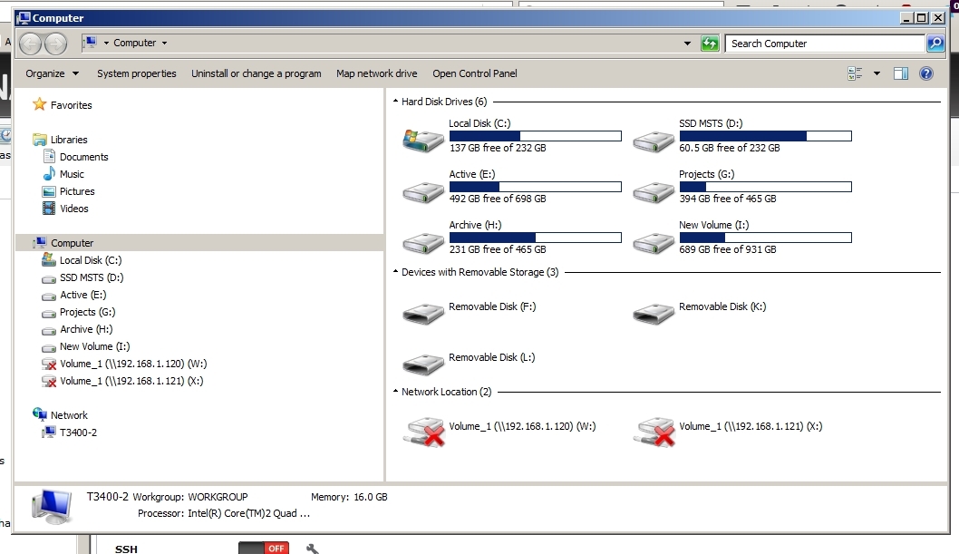

After your reset, before you do anything else, you need to see if you can see the shared folder using \\192.168.1.50 (BTW, the \\ tells Windows that it is a file server). Then figure out the name issue not showing up under network. Usually the user permissions will prevent a folder from showing up, but not the entire server. And as others have mentioned, getting the NetBIOS name to show up is usually a pain, because there are a lot of Windows things needed for that to work properly.@pirateghost: Yes, after every change, CIFS services was turned off, the turned on.
@depasseg: Yes, you are remembering perfectly. To recap.
Attempt #1. Using only the wizard, I did create a Freenas box with two volumes.
Attempt #2. The forum posting. This install was created by resetting the Freenas installation to the defaults from the keyboard of the PE840 computer. The configuration this time did not use any wizards. I created the group, the user, the volumes, and the shares manually using a combination of tutorials, forum posts, and the manual.
My task now, is to try to verify that it is not my user/group setting that is preventing Windows workstation from seeing the PE840 Freenas computer. I have deleted the user (cmk) and the group (cmk). I rebooted the PE840 and the workstation. The Freenas is not shown. So to take a step further back, I am going to reset the Freenas to it's original installation configuration. This should eliminate any of the modifications I made to the CIFS, etc. I will then use only the wizard to see if I can get the PE840/Freenas to be seen by the workstation. Should the workstation and the PE840/Freenas still not see each other...well we shall have to think this over.
