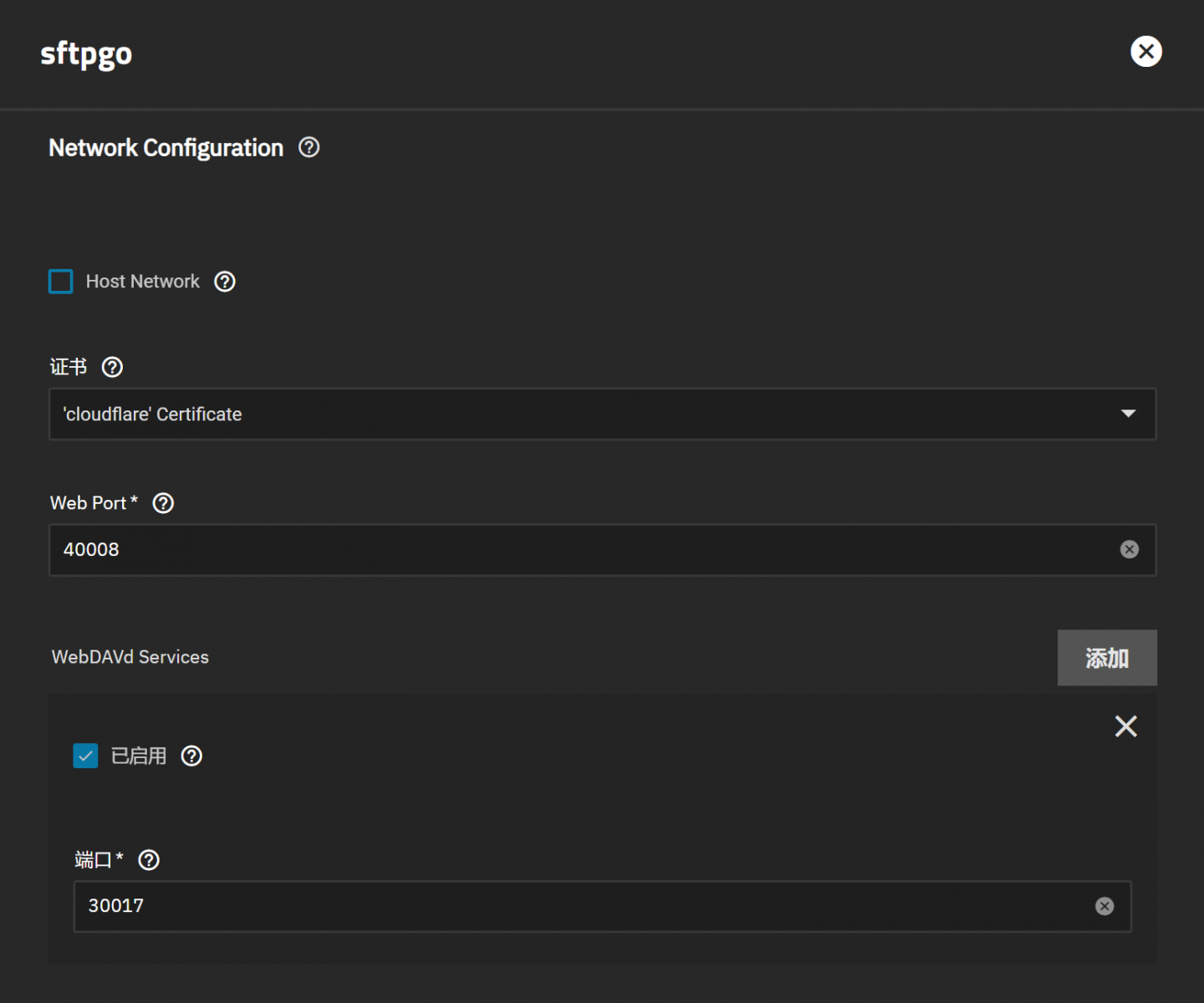

How to set WebDAV to https for the app sftpgo (or turn on SSL)
System version: TrueNAS-SCALE-22.12.4.2
Application version: sftpgo v2.5.4_1.0.1
I can't change whether WebDAV enables certificates or not under the default settings screen, but there is an option for certificates in Web Port.
I tried to call the local certificate file through the option [Additional Environment Variables] to let sftpgo enable the certificate by itself, but I found out that this is not enough permissions, because the system default permission for the certificate is root.
Then I also realized that TrueNAS SCALE is not https'ing the Web Port in sftpgo's config file, which has https set to off for both the Web Port and WebDAV Port, so I think it's very likely that this is being accomplished by some system feature.
If that's the case, some official TrueNAS changes to the sftpgo app should allow WebDAV to connect via https. I did try to run nginx in a VM for the reverse generation though, but this introduces additional performance overhead. If you use an unofficial source application again there is a good chance that it will need to be reconfigured due to upgrades later in the system.
