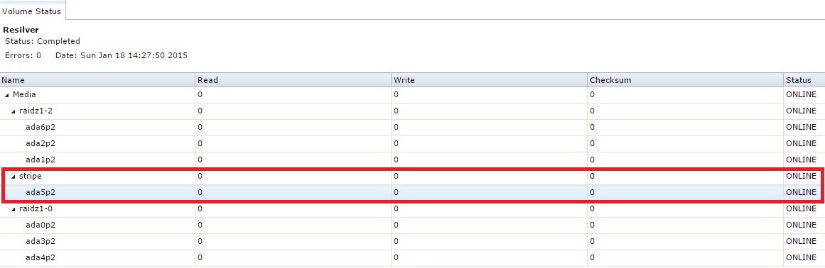

I started with a RAIDZ-1 of 3 disks. When I started to run out of room a added a single striped disk as a temp solution. Now that I have 3 new disks I expanded the volume with a second RAIDZ-1. My question is, how do I remove the single striped disk? i Understand it is a liability since it is a single point of failure. can I populate the data in that disk to the new RAIDZ-1?

Save you data, destroy the pool, re create pool, copy data back.

As Jailer said, you can't remove the drive, without destroying your pool and starting over.
However, you could mitigate the risk by adding a mirror to ada5. Unfortunately, you can't add the mirror via the webGUI. To do it, you'd need to use the command line. Read this thread to see how another use did it: https://forums.freenas.org/index.ph...-existing-stripe-to-mirror.26326/#post-166645
If you decide to go this route - be very careful. Doing stuff from the command line isn't recommended. But, it's the only way you can create a mirror after the fact.

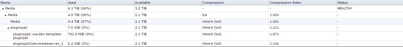

So I purchased 3x 4TB WD Reds to replace this set up. I plan on setting up a RAIDZ1 pool. I know RAIDZ1 is not the safest, but this is a media zpool. It would not be the end of the world if doomsday happens. I will still have a bit if redundancy with this setup.
My question is, how do I migrate the data to the new zpool without loosing my jails and plugins settings? I am mainly concerned with keeping the integrity of my Plex server. As I understand it I will not be able to use autoexpand due to the difference in current and planned drive configuration.
Basically I want the new zpool to look like the current one
UPDATE: Once I received the new drives I followed THIS THREAD to copy my pool to the new drives. pretty easy... I left the system do its thing over night. When I got up in the morning, It had moved just under 5TB.
