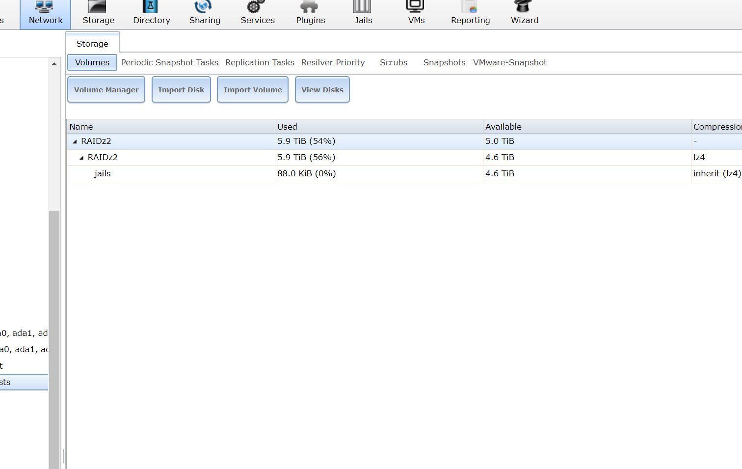

John Doe
633
ah okay, so after detaching the pool, doing the wiring stuff, i just go with import volume via the button in the screenshot?
I can't remember the old interface since I've been doing a lot of bug reports for the new one recently and I'm not currently running anything lower than 11.2-U1.
