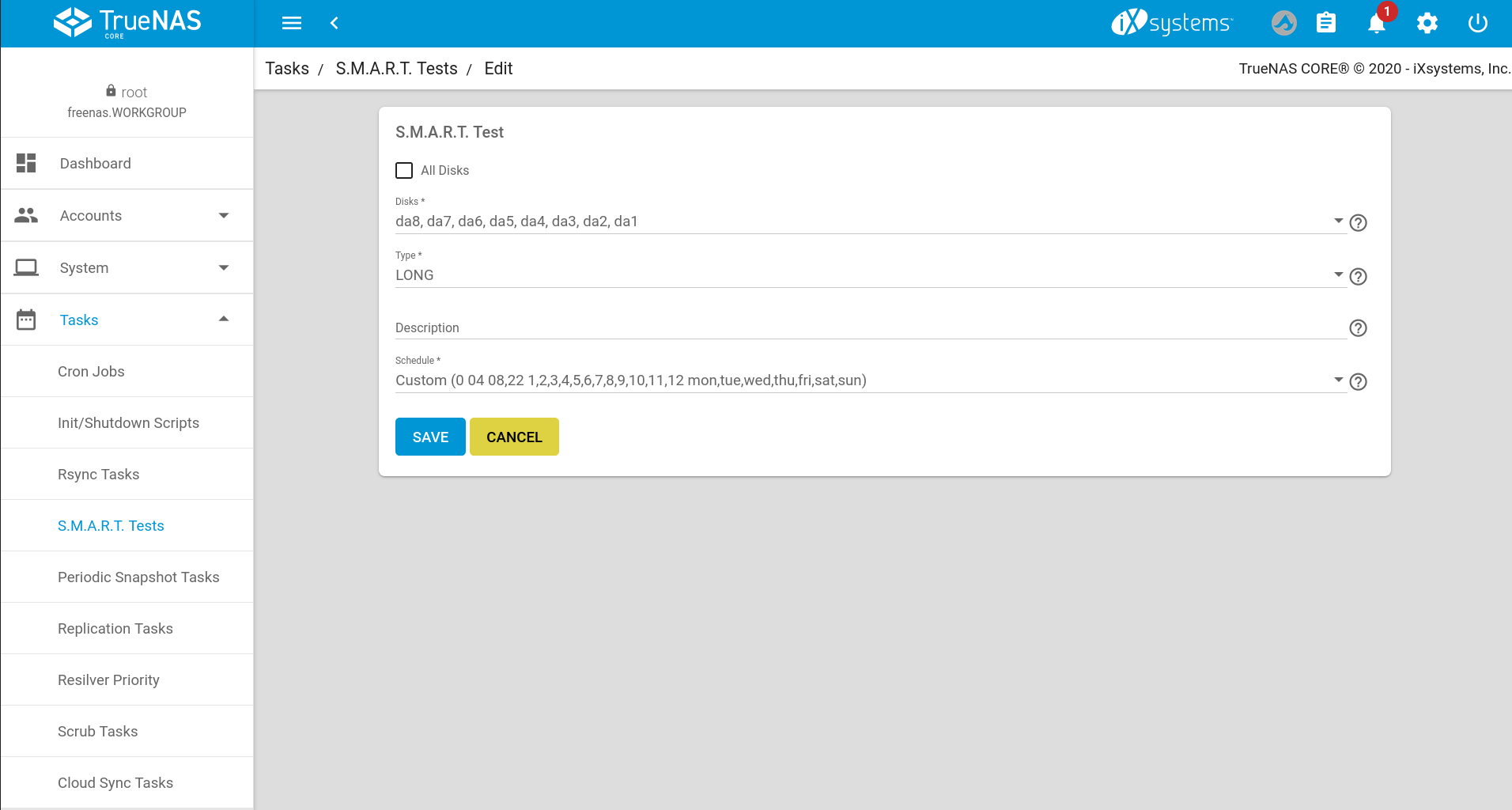

one day I decided to go ahead with ESXi and virtualized freenas. So I set up everything, got an HBA and passed it through and uploaded my exsisting config.

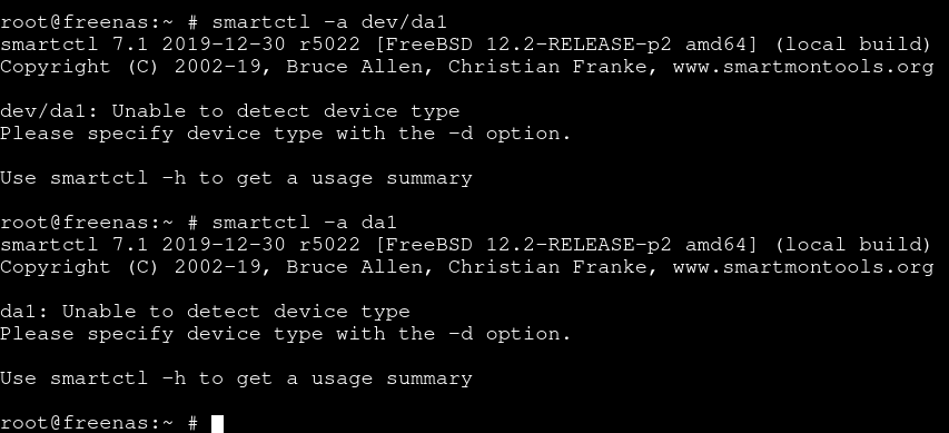

so far so good. today I wanted to check my smart values and I could not ready them out.
Is that the correct way to read them?
If that is the correct way and freenas/truenas is not able to fetch those attributes, why do I don't get an alarm for the created task?

dang it.... yes its working with /dev/da
thanks
