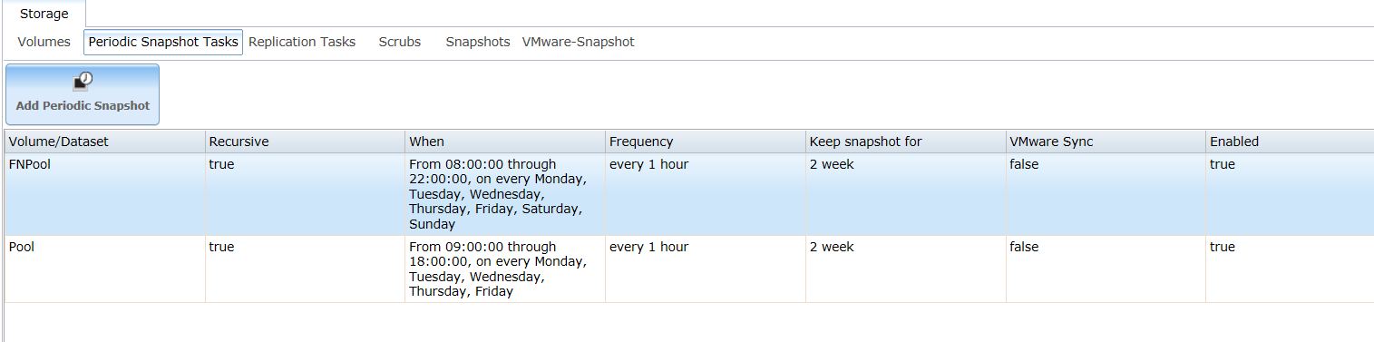

RichTJ99
Sep 12, 2013
384
Please see attached - maybe i did this wrong?
Thanks,
Rich
Bidule0hm
Server Electronics Sorcerer
Aug 5, 2013
3,710
Ok they are recursive so it should work. Did you just changed them right now?
However if it wasn't recursive when the snapshot was taken it's normal that you don't have anything in NAS/ and jails/ because they are datasets, not directories.
