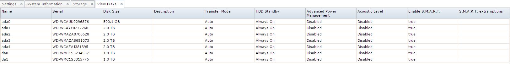

Just a note for anyone reading this thread, seems the JBOD and LSI HBA do support hot swap after all. I may just be doing it all wrong or once in a pool the drives dont like to be offlined or to fail, in which case they then go on to require a reboot? More experimentation is required here but right now my brain is spinning trying to figure out freenas 9.3 and the correct way to replace a failed drive in a mirror.
What I did immediately after deleting my test mirror pool and rebooting the server is pull the two disks, label them and plug them back into the JBOD enclosure. I noted the following message in console and the disks appear ready to be imported.
Feb  4 20:48:01 Medusa da1 at mpr0 bus 0 scbus0 target 19 lun 0
Feb  4 20:48:01 Medusa da1: <ATA WDC WD10EZEX-00R 0A80> s/n      WD-WMC1S3315776 detached
Feb  4 20:48:01 Medusa (da1:mpr0:0:19:0): Periph destroyed
Feb  4 20:48:09 Medusa da0 at mpr0 bus 0 scbus0 target 18 lun 0
Feb  4 20:48:09 Medusa da0: <ATA WDC WD10EZEX-00R 0A80> s/n      WD-WMC1S3234537 detached
Feb  4 20:48:09 Medusa (da0:mpr0:0:18:0): Periph destroyed
Feb  4 20:54:30 Medusa ses0: pass0,da0: Element descriptor: 'Slot04'
Feb  4 20:54:30 Medusa ses0: pass0,da0: SAS Device Slot Element: 1 Phys at Slot 4
Feb  4 20:54:30 Medusa ses0:  phy 0: SATA device
Feb  4 20:54:30 Medusa ses0:  phy 0: parent 50030480017a383f addr 50030480017a3804
Feb  4 20:54:30 Medusa da0 at mpr0 bus 0 scbus0 target 12 lun 0
Feb  4 20:54:30 Medusa da0: <ATA WDC WD10EZEX-00R 0A80> Fixed Direct Access SCSI-6 device
Feb  4 20:54:30 Medusa da0: Serial Number      WD-WMC1S3315776
Feb  4 20:54:30 Medusa da0: 1200.000MB/s transfers
Feb  4 20:54:30 Medusa da0: Command Queueing enabled
Feb  4 20:54:30 Medusa da0: 953869MB (1953525168 512 byte sectors: 255H 63S/T 121601C)
Feb  4 20:54:38 Medusa ses0: pass1,da1: Element descriptor: 'Slot05'
Feb  4 20:54:38 Medusa ses0: pass1,da1: SAS Device Slot Element: 1 Phys at Slot 5
Feb  4 20:54:38 Medusa ses0:  phy 0: SATA device
Feb  4 20:54:38 Medusa ses0:  phy 0: parent 50030480017a383f addr 50030480017a3805
Feb  4 20:54:38 Medusa da1 at mpr0 bus 0 scbus0 target 13 lun 0
Feb  4 20:54:38 Medusa da1: <ATA WDC WD10EZEX-00R 0A80> Fixed Direct Access SCSI-6 device
Feb  4 20:54:38 Medusa da1: Serial Number      WD-WMC1S3234537
Feb  4 20:54:38 Medusa da1: 1200.000MB/s transfers
Feb  4 20:54:38 Medusa da1: Command Queueing enabled
Feb  4 20:54:38 Medusa da1: 953869MB (1953525168 512 byte sectors: 255H 63S/T 121601C)
