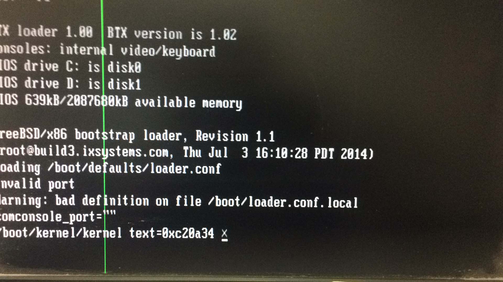

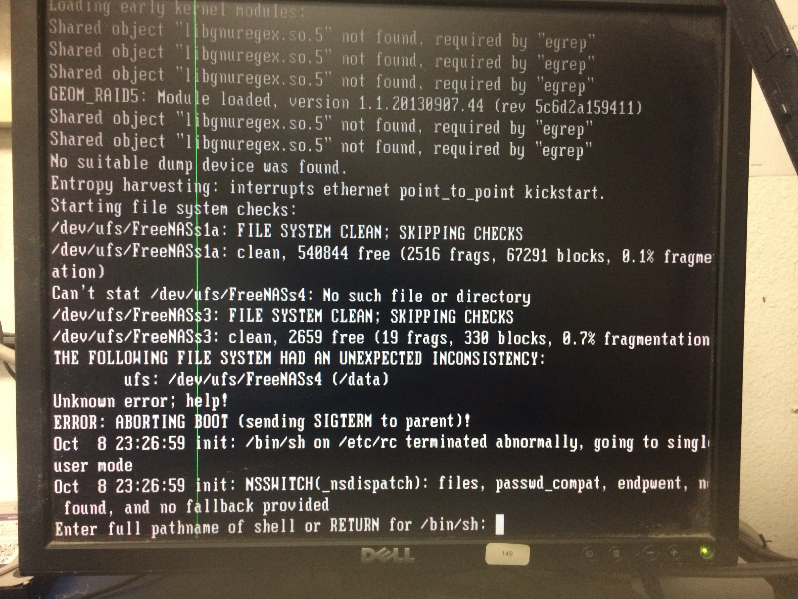

Hi, Help
SUESITES
Oct 8, 2018
4

Please do not cross post your question in two places, it makes extra work for people.
If you could read the first screens of when the system boots then you should be able to abort the bootstrap process and enter the command uname -a and report what it states. This looks like an early version of FreeNAS, maybe 8.x, but I can't tell.

Thank You For That.
I have an update, I set-up a new system with the FREENAS current version. Took my old drive 2tb with my data. imported the drive and now i'm back up and running. All is Good
