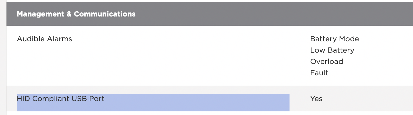

1. Per the manufacturer site, the USB communication port is HID compatible.

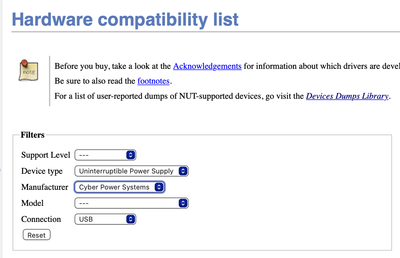

2. TrueNAS uses NUT https://networkupstools.org. It appears from the HW compatibility list, that all of the USB connected CyberPower models use the USBHID-UPS driver.
