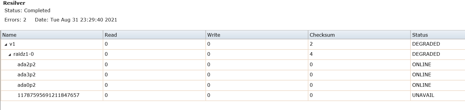

@Spearfoot Thank you very much for your advice. In fact and as you have pointed out, I have several SATA ports available on my Motherboard. However before trying this, could you please look at the "zpool status -v" result of my pool. I've tried to replace the failed disk, however even after the resilvering it still shows that the pool is degraded.
[root@freenas] ~# zpool status -v v1
  pool: v1
 state: DEGRADED
        corruption.  Applications may be affected.
action: Restore the file in question if possible.  Otherwise restore the
        entire pool from backup.
   see: http://illumos.org/msg/ZFS-8000-8A
  scan: resilvered 6.82G in 11h55m with 2 errors on Tue Aug 31 23:29:40 2021
config:
        NAME                                              STATE     READ WRITE C                                         KSUM
        v1                                                DEGRADED     0     0                                              2
          raidz1-0                                        DEGRADED     0     0                                              4
            replacing-0                                   DEGRADED     0     0                                              0
              11787595691211847657                        UNAVAIL      0     0                                              0  was /dev/gptid/af39dcf0-f73d-11e4-b3c4-989096a87096
              gptid/0a5e00ef-09e2-11ec-8625-989096a87096  ONLINE       0     0                                              0
            gptid/afb610ef-f73d-11e4-b3c4-989096a87096    ONLINE       0     0                                              0
            gptid/11fe4998-3efb-11eb-b64c-989096a87096    ONLINE       0     0                                              0
        <0x4d9>:<0x1c7d1>
I also don't understand how one file got corrupted, as I have ECC memory in the server. I have deleted the file in question, however it still shows the error.
Do you think that I would be able to import this zpool named "v1" into a Truenas 12U5 version and copy the data that way?
Many thanks once again for all the advice.

I recommend you get your pool repaired before trying to clone it.
Johev
Nov 26, 2014
107
How do I understand what the problem is? It has 3 4TB HDDs, 2 of them are new as the old ones started to fail after 4,5 years of non-stop use. I don't understand how to remove the old unplugged disk. I did follow the procedure to replace the disk in the GUI and it all went well, except now I am left with the "unavailable" disk.
It also shows me that there are 2 erros, without any information on what is wrong. Any advice would be greatly appreciated.
I hesitate to give any advice because I have little experience with this type of problem and I don't know exactly what you did.
I'm not even certain whether you have 3 disks in your raidz1 pool, or 4.
Perhaps someone more knowledgeable will stop by and give us a clue.
Etorix
Dec 30, 2020
2,134
There are three drives, one of which is in the process of being replaced. If @Johev still has the old drive, he may try to put it back and scrub again.
Then there is an error in a metadata file. I know of no way to repair that; human checking of the data will be required.
