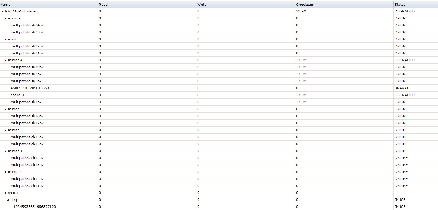

i run into some problem replacing bad disks, i tried to backup disk to a spare and replace a bad disk, for some reason i cannot get the pool to work again, and i cannot get disk to go offline or replacing it, from gui the it is just wont work...
i need some help resolving this issue please!

zpool status -v | more
give this:
is it possible to save anything from this pool?
RAID10-Vstorage
state: DEGRADED
status: One or more devices is currently being resilvered. The pool will
continue to function, possibly in a degraded state.
action: Wait for the resilver to complete.
scan: resilver in progress since Tue Sep 12 09:06:50 2017
737G scanned out of 1.22T at 50.2M/s, 2h54m to go
9.07G resilvered, 58.84% done
config:
NAME STATE READ WRITE CKSUM
RAID10-Vstorage DEGRADED 0 0 13.7M
mirror-0 ONLINE 0 0 0
gptid/a9f8359c-54fc-11e7-a8bd-e83935bc7728 ONLINE 0 0 0
gptid/ad6ab7ce-54fc-11e7-a8bd-e83935bc7728 ONLINE 0 0 0
mirror-1 ONLINE 0 0 0
gptid/b0e4d652-54fc-11e7-a8bd-e83935bc7728 ONLINE 0 0 0
gptid/b452b4fd-54fc-11e7-a8bd-e83935bc7728 ONLINE 0 0 0
mirror-2 ONLINE 0 0 0
gptid/b7c8fa85-54fc-11e7-a8bd-e83935bc7728 ONLINE 0 0 0
gptid/bb4418c0-54fc-11e7-a8bd-e83935bc7728 ONLINE 0 0 0
mirror-3 ONLINE 0 0 0
gptid/becd26a2-54fc-11e7-a8bd-e83935bc7728 ONLINE 0 0 0
gptid/c24868ab-54fc-11e7-a8bd-e83935bc7728 ONLINE 0 0 0
mirror-4 DEGRADED 0 0 27.5M
gptid/b15d2ccb-95f8-11e7-b503-e83935bc7728 ONLINE 0 0 27.5M (resilvering)
replacing-1 DEGRADED 0 0 27.5M
spare-0 DEGRADED 0 0 27.5M
replacing-0 DEGRADED 27.5M 0 0
450655911209013653 UNAVAIL 0 0 0 was /dev/gptid/c946d9e8-54fc-11e7-a8bd-e83935bc7728
gptid/bfa2fd71-95fc-11e7-b503-e83935bc7728 ONLINE 0 0 27.5M (resilvering)
gptid/74505882-95fc-11e7-b503-e83935bc7728 ONLINE 0 0 27.5M (resilvering)
gptid/82f5b205-95fb-11e7-b503-e83935bc7728 ONLINE 0 0 27.5M (resilvering)
mirror-5 ONLINE 0 0 0
gptid/ccc6fc55-54fc-11e7-a8bd-e83935bc7728 ONLINE 0 0 0
gptid/d0528a1f-54fc-11e7-a8bd-e83935bc7728 ONLINE 0 0 0
mirror-6 ONLINE 0 0 0
gptid/d42b2c6c-54fc-11e7-a8bd-e83935bc7728 ONLINE 0 0 0
gptid/d7e25edc-54fc-11e7-a8bd-e83935bc7728 ONLINE 0 0 0
spares
10345938651656877100 INUSE was /dev/gptid/74505882-95fc-11e7-b503-e83935bc7728

It looks like the pool is still resilvering. If you still have issues after zpool status indicates that a resilver isn't still in progress, let us know.
It's already showing metadata corruption (besides the errors in the .system dataset, but those can be worked around), so it's definitely a "get all the data off that pool ASAP" kind of situation.
Tomer
Jun 26, 2017
17
Can you advice how can i copy the data from the disk?
Tomer
Jun 26, 2017
17
here is the output for zpool status -v | more
pool: RAID10-Vstorage
state: DEGRADED
corruption. Applications may be affected.
action: Restore the file in question if possible. Otherwise restore the
entire pool from backup.
see: http://illumos.org/msg/ZFS-8000-8A
scan: resilvered 11.0G in 6h41m with 22613957 errors on Tue Sep 12 15:48:48 2017
config:
RAID10-Vstorage DEGRADED 0 0 22.2M
mirror-4 DEGRADED 0 0 44.6M
gptid/b15d2ccb-95f8-11e7-b503-e83935bc7728 ONLINE 0 0 44.6M
replacing-1 DEGRADED 0 0 44.6M
spare-0 DEGRADED 0 0 44.6M
replacing-0 DEGRADED 44.6M 0 0
gptid/bfa2fd71-95fc-11e7-b503-e83935bc7728 ONLINE 0 0 44.6M
gptid/74505882-95fc-11e7-b503-e83935bc7728 ONLINE 0 0 44.6M
gptid/82f5b205-95fb-11e7-b503-e83935bc7728 ONLINE 0 0 44.6M
spares

Do you have Backup? Your going to want to use your backup or make one really fast. A 10TB hdd is pretty cheap.

i dont have a 10TB hdd,
is there a way to connect to the pool and copy some data from it?
Huh? Of course there is it's a nas that is what it's purpose is. You use smb, nf, should, rsync, afp to move data over a network. Does that make sense? I think I might be understanding you wrong because that answer I just gave is silly. What do you mean by connect to the pool? How did you get all your data in there in the first place?
the pool is a iscsi mounted to ESXi's.
after its start to be degraded mode, it cannot be reached.
i tried as you sugested to configure it to be SMB, but its unreacheble(i can see only the JAIL folder)...

Can you reconnect the first disk you removed?
SMART data from that disk and the remaining disk would be good.

Can you reconnect the disk you removed?
No..
rs225
Jun 28, 2014
878
The first disk removed may be the only way to get the pool back to normal operation.
The other possibility is a bad cable on the other remaining disk. 27.5 million errors is very high.

The problem starts when i tried to get disk to go offline, then i get this error:
is this a bug?
is this a bug?

I don't think you understand. You have multiple driver failures so all your data is gone. You need to destroy everything, rebuild your pool with working disk then restore your data from your backup. You can't offline a disk, you can't replace a disk. This is just what happens when multiple disk fail in a vdev.
Do you have smartctl -a info for the failed disks? We should make sure they are actually dead.

That isn't a bug. You can't offline a disk when you are in the degraded mode.
Do you still have the first disk? If so, you must connect it without removing any of the other related disks. The only other possibility is to figure out why you have so many errors and fix that problem if possible.
