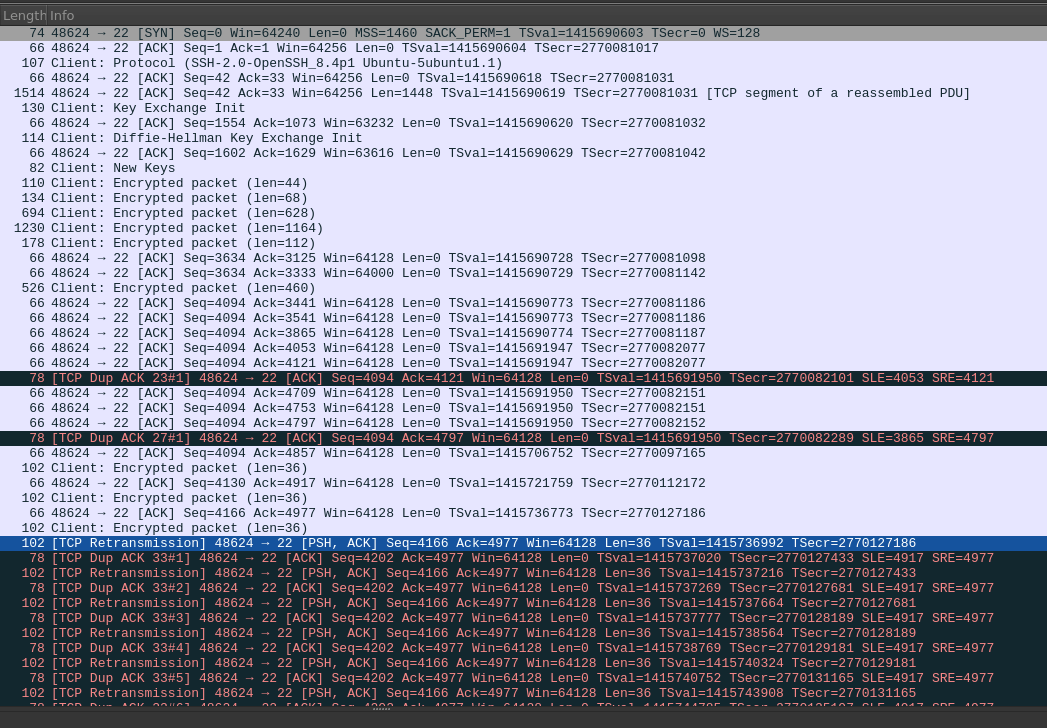

Since BETA 2 (and now RC1), I’ve had issues when accessing a local service directly on my TuesNAS Scale server over a routed IP (192.168.0.10 > 192.168.1.5), but on the same subnet no problems (192.168.1.4 > 192.168.1.5). The service becomes unresponsive after about a minute and then I have to reconnect / refresh. I’ve observed this behavior in HTTPS/SMB/NFS/SSH. I expect iSCSI would have this issue, but can’t be bothered to test since the big 4 experience this issue anyway.

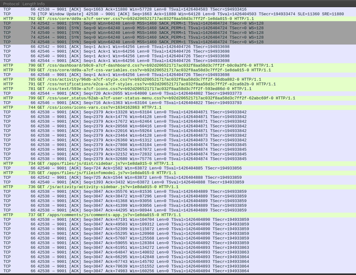

Here you can see normal activity, couple dropped packets, and then outright packet loss. This is a packet capture from pfsense, it's passing everything between the two:

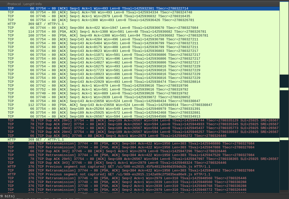

Just in case, same issue observed in HTTP (80/tcp):
And here is a capture from using nextcloud via the same interface to a container (9001/tcp):

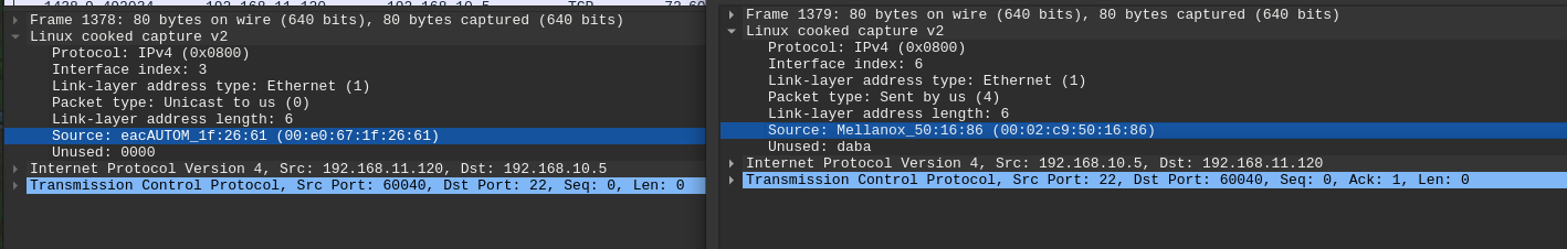

Does your TrueNAS Scale host have multiple interfaces? If it does, could you try a packet dump on all interfaces while connecting to one of the impacted services, like so:
tcpdump -vne -i any -w all_interfaces.pcap
When you look at it in Wireshark, are the response packets going out on the same interface that the original requests came in on?

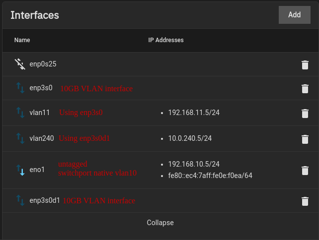

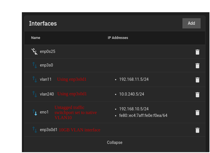

Thanks for thinking this through with me. I indeed have multiple interfaces, and it does look like it's sending out of the wrong interface. I recently moved the IP to a different interface while troubleshooting this issue - it was originally on a Mellanox 10gb card. I thought maybe it was the driver or something with the card, so I deleted the VLAN10 interface I created, setup a switchport to native vlan10, and connected the ethernet to an available port on the box. This way I thought I'm removing vlan tags from the equation and an older NIC.
Funny though, it starts off this way and "works" for 30-60 seconds.
Desktop > Scale: 1gbe correct NIC
Scale > Desktop: 10gb old NIC.
