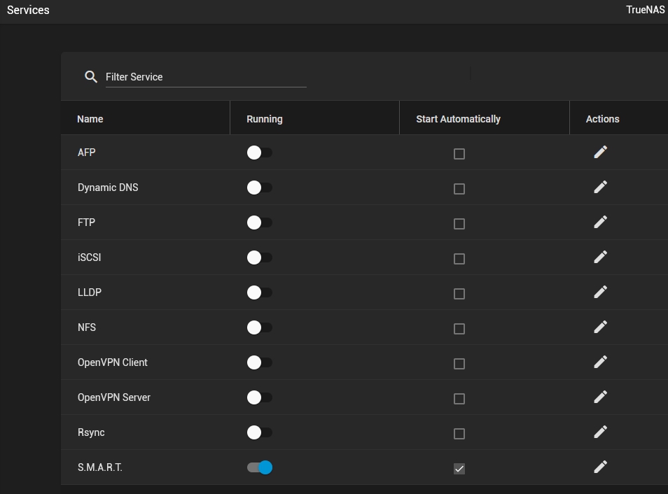

In the GUI, navigate to Services. Click the pencil to edit the S3 service, and then just OK the default settings. Once back at the Services screen, blip the toggle to turn the service on, then off.
Hi!
It looks like I don't have a S3 service?
It says "Error starting service S3" when I try to do as you explained.
I should add that when I click the pencil to edit the default settings, the 'Save' is greyed out. IF I try to edit any field, just to see if 'Save' wakes up, nothing has any effect on it. So I come back out of configure and try to turn the service on and I get the above error message.
Samuel Tai
Apr 24, 2020
5,399
OK, it looks like a corrupted install. Try going to System->Boot, and activating your previous 12.0-U7 boot environment. Reboot back into U7, and try upgrading again.
