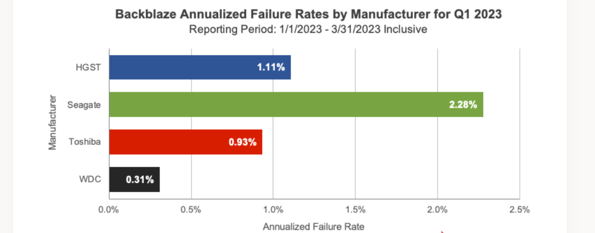

@joeschmuck
seems seagate is not a big deal ;/ comparing to the wdc

joeschmuck
Old Man
May 28, 2011
10,996
Ouch, glad you checked. Guess Seagate is not doing as well this year, but 2.28% is still a low number. You should see if you can break those down by model as well.
