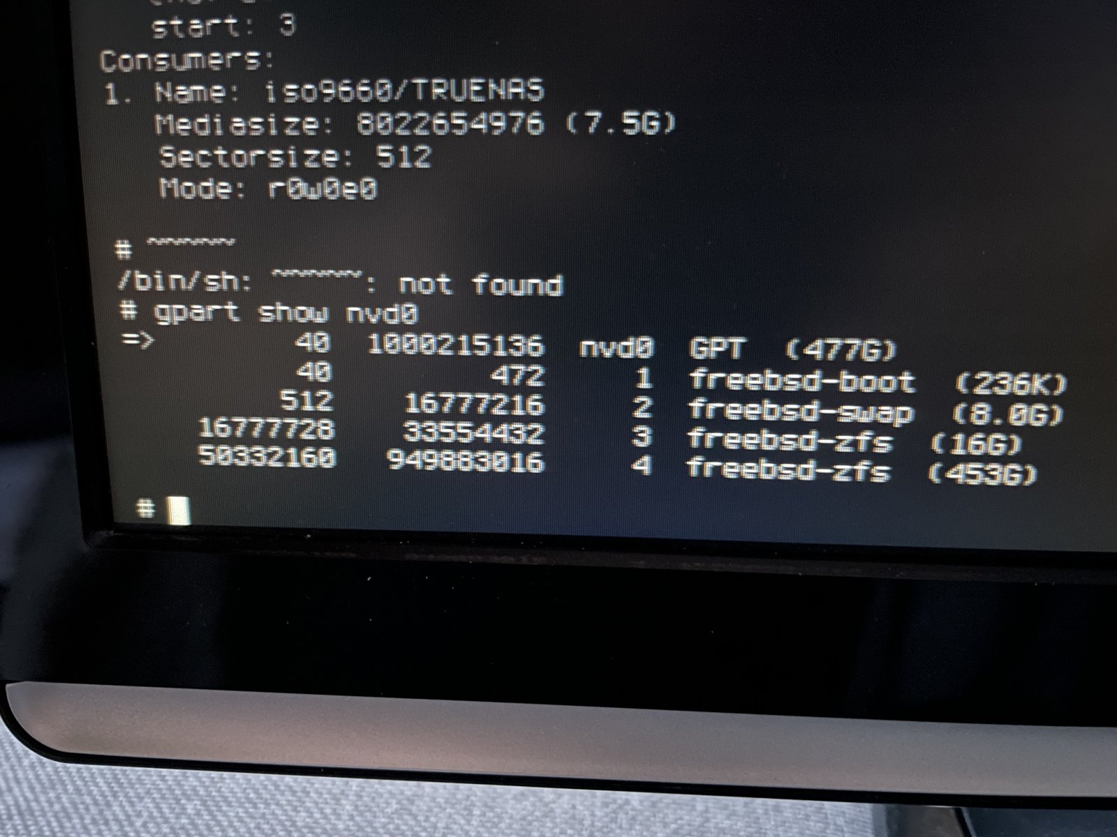

In preparation I already deleted the pool that was on the SSD. So I am basically looking at an empty SSD now.
I found the thread you have mentioned as well. But reading through the command lines I find the one I have linked very understandable.
There is just one question I have regarding the thread I have linked when it comes to mirroring. It says:
			#setup boot as mirror from our usb drive (usb drive B is da0, da0p2 is the freenas-boot pool)
zpool attach freenas-boot /dev/da0p2 /dev/ada0p3
#wait for resilver! run 'zpool status' to check status
zpool offline freenas-boot /dev/da0p2
zpool detach freenas-boot /dev/da0p2
Here - from what I understand - you are actually taking the exact same partition from the USB stick and mirror it to the newly created partition on the SSD, correct? This would mean I 'copy' all of the files and configurations from the USB stick as well.
I will back up in any case and don't have a problem with a fresh install. Hmm
I guess one thing to consider are the partition sizes I am creating on the SSD. Because if they are not identical as the ones on the USB stick, I will waste space if I just blindly mirror from USB-->SSD. Hmm
