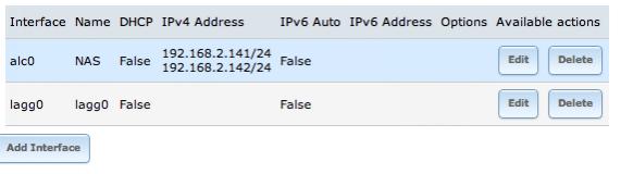

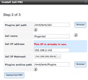

Hey,
I have tried a couple of times to setup the plugins but get stuck.
Im following Pr0t0sd on http://youtu.be/07yR0igpeao
I have added tank, tank/Plugins and tank/Jail.
But when I setup the Plugin settings from within the services panel, I have made an alias for another IP for the jail. But it says that the IP is in use. However I can enter one that is not being used and it lets me install (then I add that ip to the alias after), but when I run jls in the shell no ip shows up.
I have attached some pics of the error and my settings. I do have a load balancing setup (although not using atm), if this may have anything to do with the prob?
Thanks in advance
