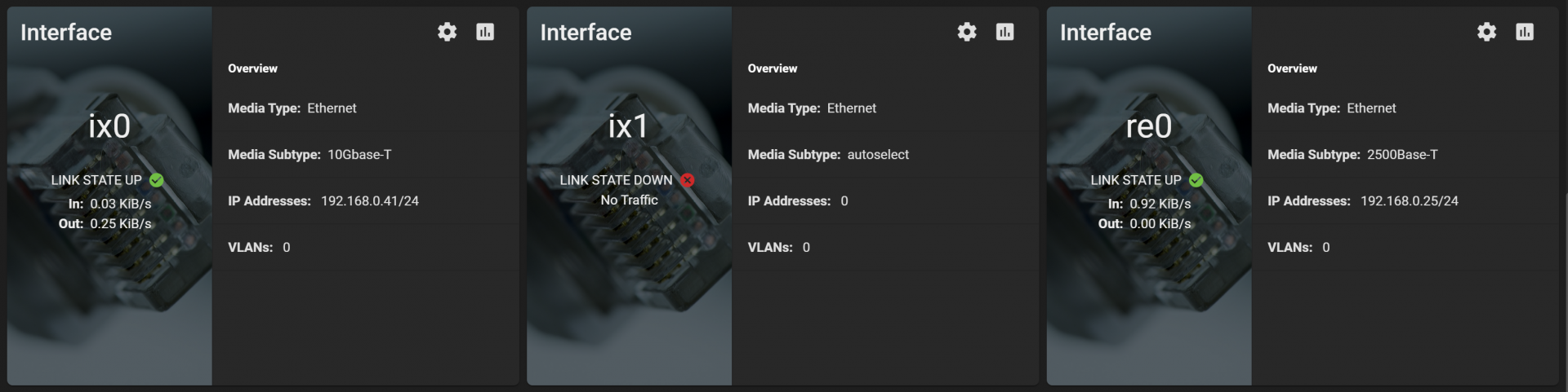

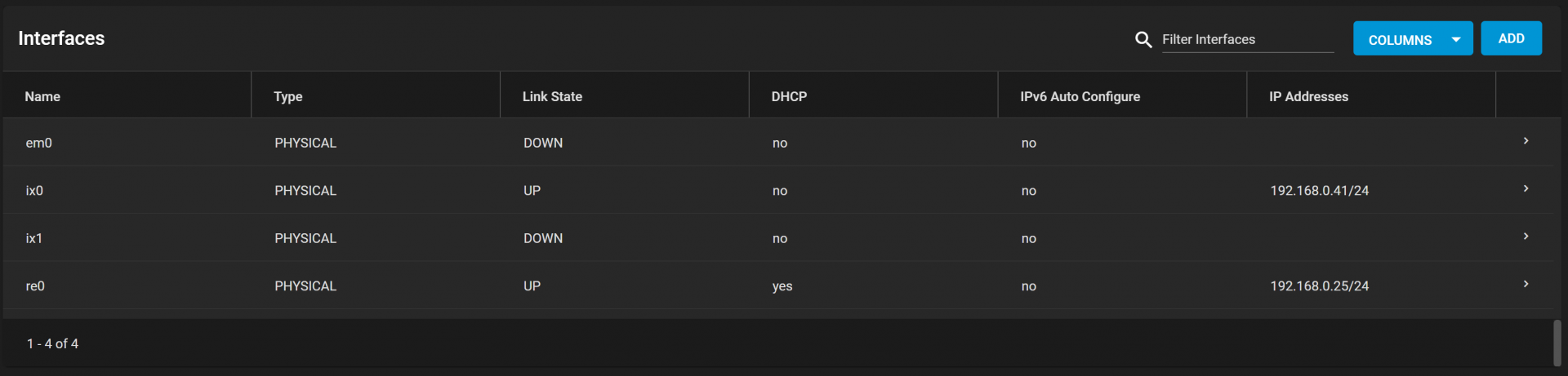

em0 is the 1gb port built into the motherboard
re0 is the port on the 2.5gb asus nic
ix0 and ix1 are the dual ports on the 10gb intel nic, for which I'm using ix0

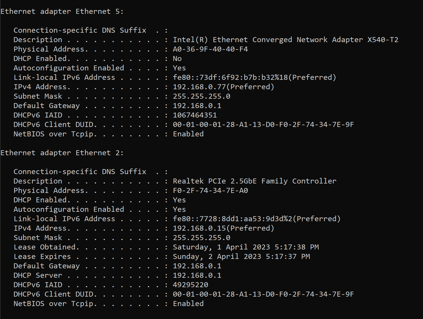

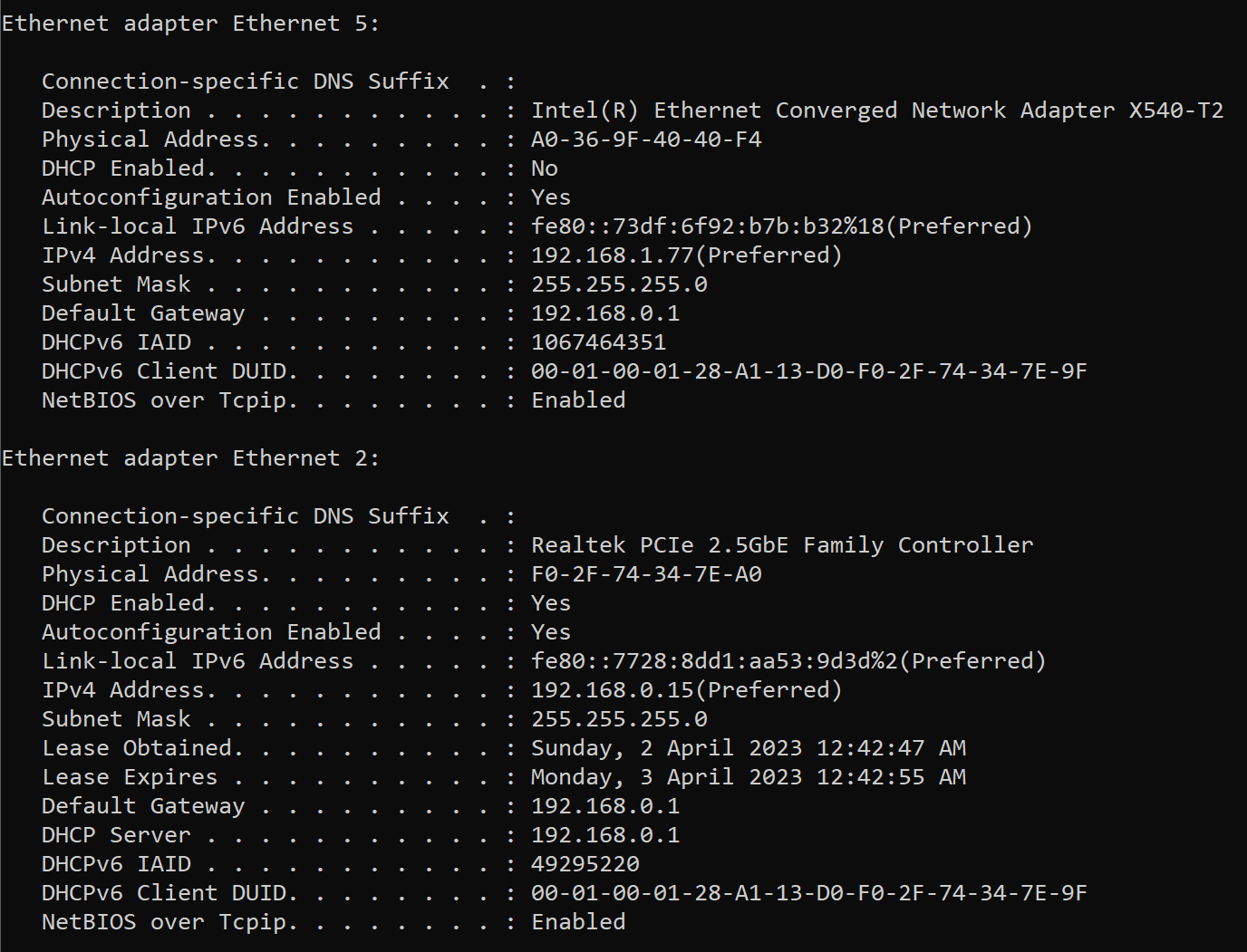

Windows PC: ipconfig /all
re0 in TrueNAS is connected to the 2.5gb Realtek port built into my PC's motherboard
ix0 in TrueNAS is connected to the first port of the same 10gb intel nic insalled in my PC

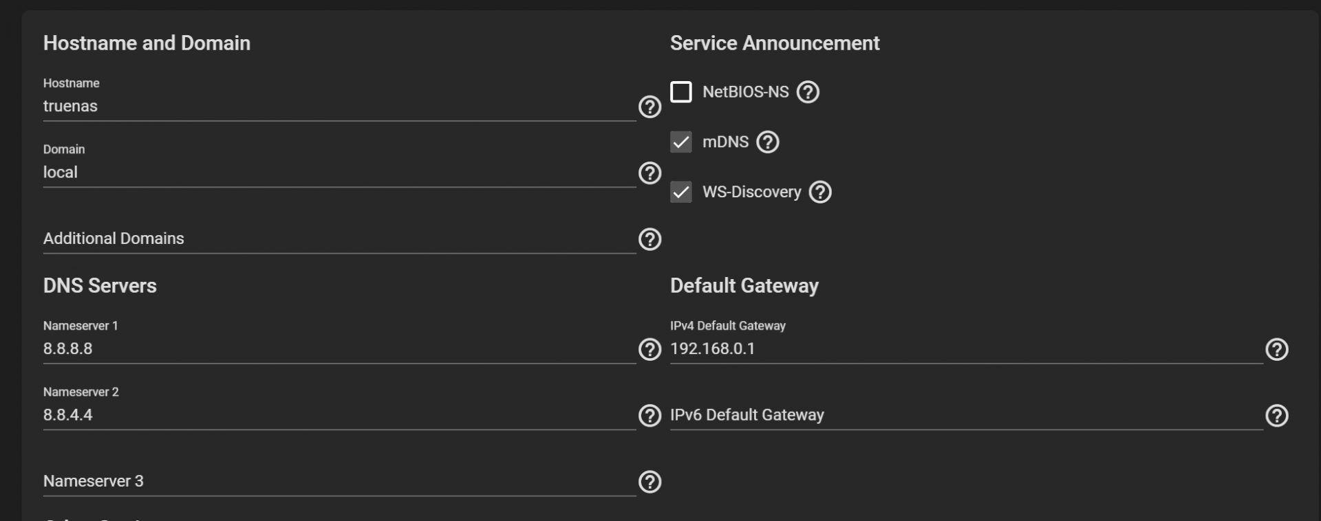

Network Global Configuration

Your issue is that you have two NICs on the same subnet.
To fix this, put the two 10GB NICs on static addresses on a different subnet that that of the rest of your network - say 192.168.1.10 and 192.168.1.11 respectively. Put your two 2.5GB NIC's with statics on say 192.168.0.XXX and 192.168.0.YYY where XXX and YYY are not in the range where your DHCP server is allocating addresses.

thanks for the reply, I continued to play around with it since I posted and this is my current setup
Which I can now access the TrueNAS gui with both 192.168.0.41 and 192.168.1.41, but I still can't access either from within windows.
\\TRUENAS does show up under Networks, which is my TrueNAS but it wont connect either

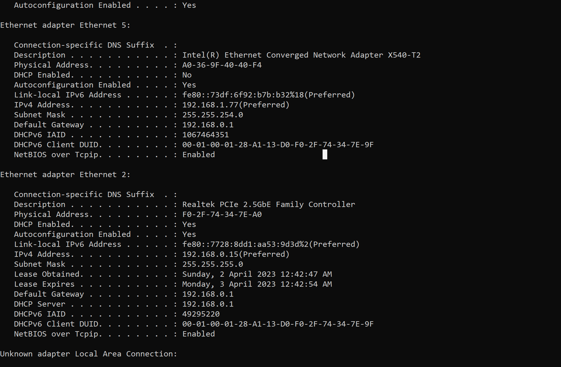

I changed the subnet mask on my PC for my 10gb intel nic to 255.255.255.0

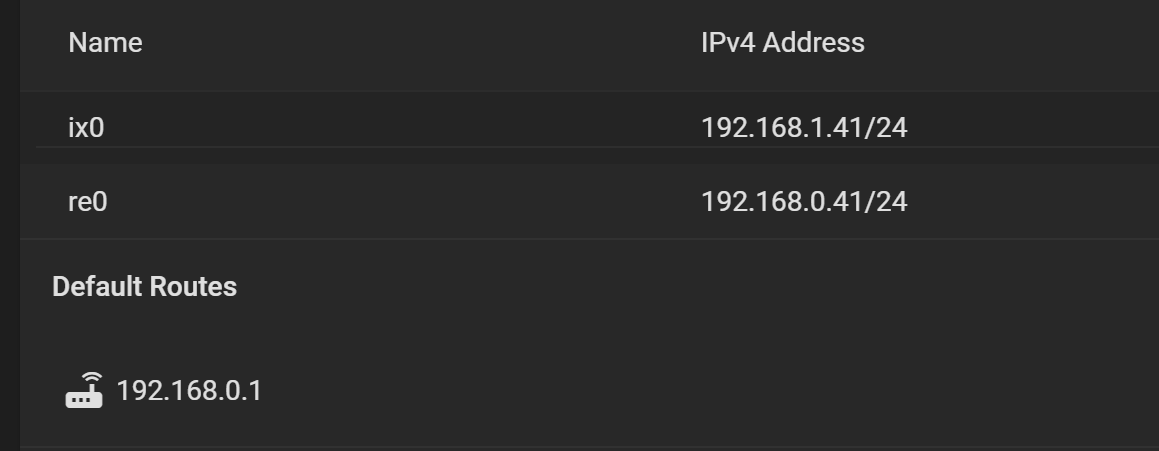

So on TrueNas
2.5gb nic (re0) has a static ip of 192.168.0.41
10gb nic (xi0) has a statip ip of 192.168.1.41
On windows PC
2.5gb (motherboard port) has DHCP enabled and assinged 192.168.0.15
10gb nic has a statip ip of 192.168.1.41
both have a subnet mask of 255.255.255.0 and a defalt gateway of 192.168.0.1
And as I mentioned I can access the TrueNAS gui in the browser using
//192.168.0.41
//192.168.1.41
//truenas.local

ip address for the intel nic installed in PC is still and has always been 192.168.0.77, as reflected in the previous screenshots. I have tried changing all the ips around but still can't connect.
The fact I can access the TrueNAS gui in the browser using //192.168.0.41, //192.168.1.41 and //truenas.local, mean that there are no issues with conflicting ips and that the issue is somewhere else.
I have changed //192.168.1.41 to //192.168.1.51 so that the last numbes are all different but still nothing.
