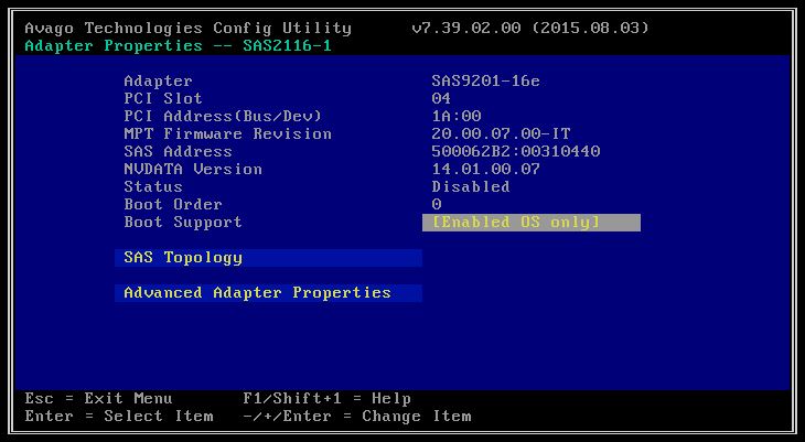

I know im reviving a 5 year old thread but this helped me a lot after running into this issue on a gigabyte mobo I was using as a platform to flash an LSI HBA I had. I wanted to make sure the_freenas_noob's solution is clear for anyone who found this thread via a google search like I did. After entering the HBA pre boot config utility and selecting your HBA there is an option for boot support. For my purposes I selected Enabled by OS only, see below screen shot;
After setting this option I was able to get past the hang at "Verifying DMI pool data". I also did not run into any issues after transfering the card to my IBM x3550 M3. Also as a side note dont be alarmed if the LSI card does not see disks on boot I belive this is normal as OS only prevents the BIOS from managing/detecting the disks. After Freenas booted It was able to use the disk inserted into my Dell MD1220.
