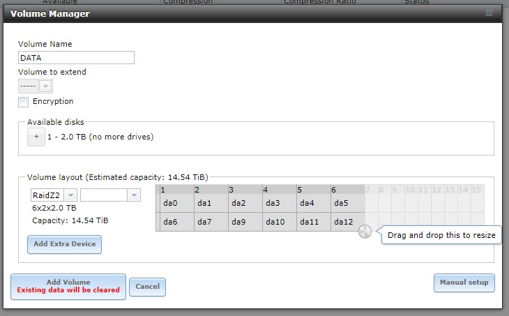

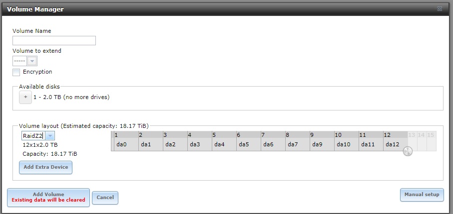

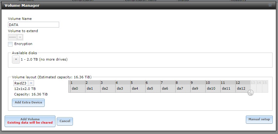

When I went to create the volume and realized I had a few options. Here's what I've come up with:
How should I be configuring for 2 disk failure and most possible storage. I read somewhere that I shouldn't be going with the RaidZ2 with all the disks in a row options because it's 12 disks in one array. I'm assuming the RaidZ2 options is 2 6 disk arrays? is that 4 disk failure, 2 per array? I'm a little lost here, and 14.54TB out of 24TB (21 actual) was a lot more loss than I was expecting.
